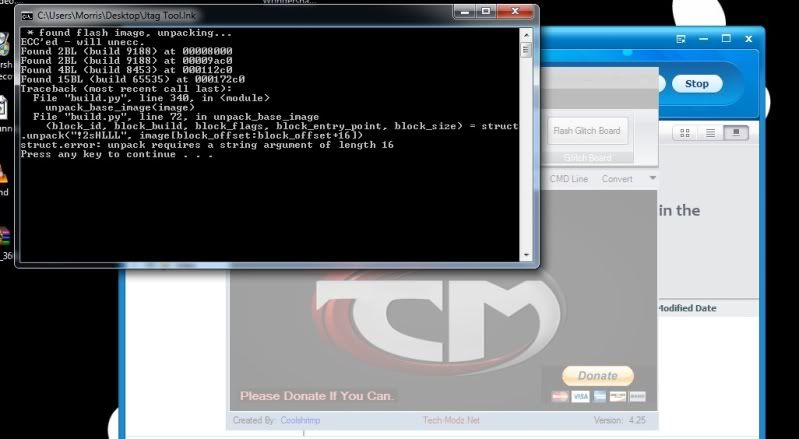

it wont let me open it. keep getting error. it just lets me open the freeboot file. long story short. I lost the original nand and the ecc, wrote the ecc. (pc crashed so lost all data)
had to reinstall windows n all. did a reading again of the nand (dont know if because I wrote the .ecc file the nands are no good. but I am able to boot into xell and get cpu and dvd key.

When you run multibuilder I assume you get this error? What version are you using? (I did my testing with v3)
I did the steps you said you did. Built the glitch image from a NAND that had the ECC patch done to it. It appears that as martin said, it should work but you will need to manually insert the LDV in to the 'options.ini' under the variable line 'cfldv = '
Does the rebuilt image open in 360 Tool at all? I tried that as well and mine did, but as previously indicated by the error, the LDV was wrong and set to 0.
yes this is the error Im receiving. I am using v3. I could open the rebuilt image w/ 360 tool. but it wont let me edit it. my ldv is also set to 0. I will try to manually insert the ldv in the options. ini. my xell only shows 2 f's in line 7 and 0 in 8. so I guess Im replacing ldv 0 w/ 2?
