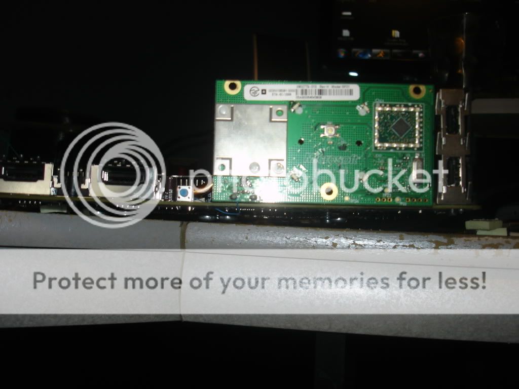

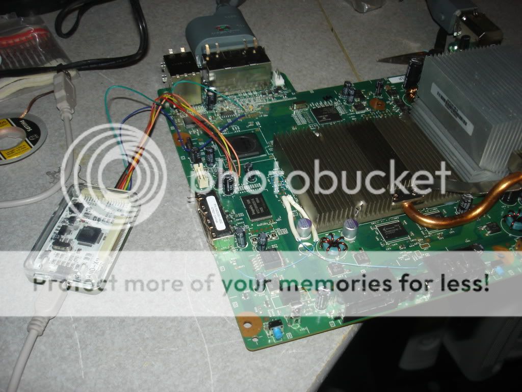

Hey again , I have a exploitable falcon Cb5766 Dash 7357 Im using db1f1 and the rf module jtag points i also tried aud_clamp & dvd tray method both attempts to install xell resulted in e79 1 red light...

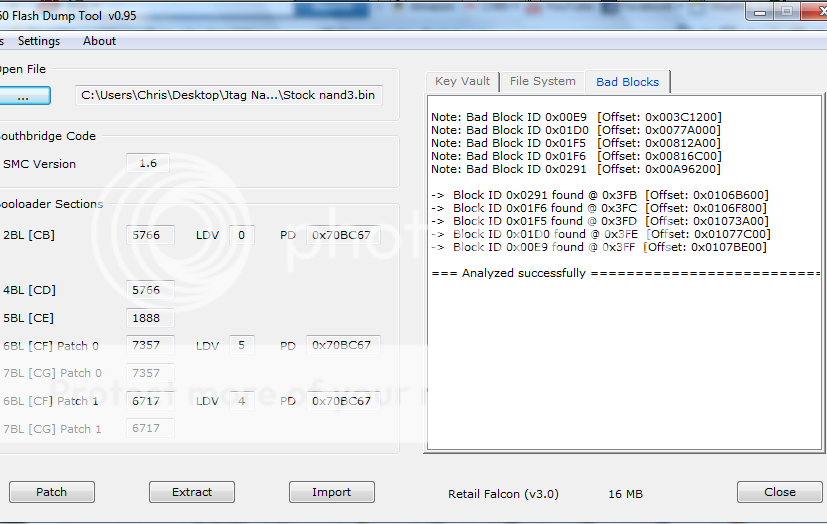

ill post a few pics of my current config below ... my only worry is the bad blocks there was 5 of them also my nands 1-2 dont match here is the block:
1024 block(s) in nand image
1 non-matching block(s) found
1D0
what do you guys think is the issue i removed wires and booted to stock dash btw so its not a hardware issue:rolleyes:

check your soldering as most the time thats what causes e79 error on jtags, also remap the bad block your nand image with xnand healer download from here

omfg did you guys notice i had the jumper in the wrong holes wow i feel like a noob anyway got xell ill answer back after freeboot...:eek:

Would say bad blocks. that's the usual cause.

Which image are you remapping? The original one which you use to make the freeBOOT image or the created freeBOOT image itself?

i unmapped my stock nand ,created freeboot using my unmapped stock nand then remapped the unmapped freeboot nand ...is this right?

unmapped ? remap the bad blocks or block on your original nand save the remapped nand then make your freeboot with the nand you remapped and write it to your Jtag nand when complete plug out the power plug on the back of the 360 wait for a min there abouts and plug it back in and try it.
Well...there are three ways of doing it.
1. Don't remap the original NAND image but remap the freeBOOT image.
2. Remap the original NAND image but don't remap the freeBOOT image.
3. Remap the original NAND image as well as remap the freeBOOT image.
The 1st way usually works, but if it doesn't work, then you should try the other 2 options.

yes im using jtag tool and i just remapped like you said and still the same problem here are my bad blocks:
