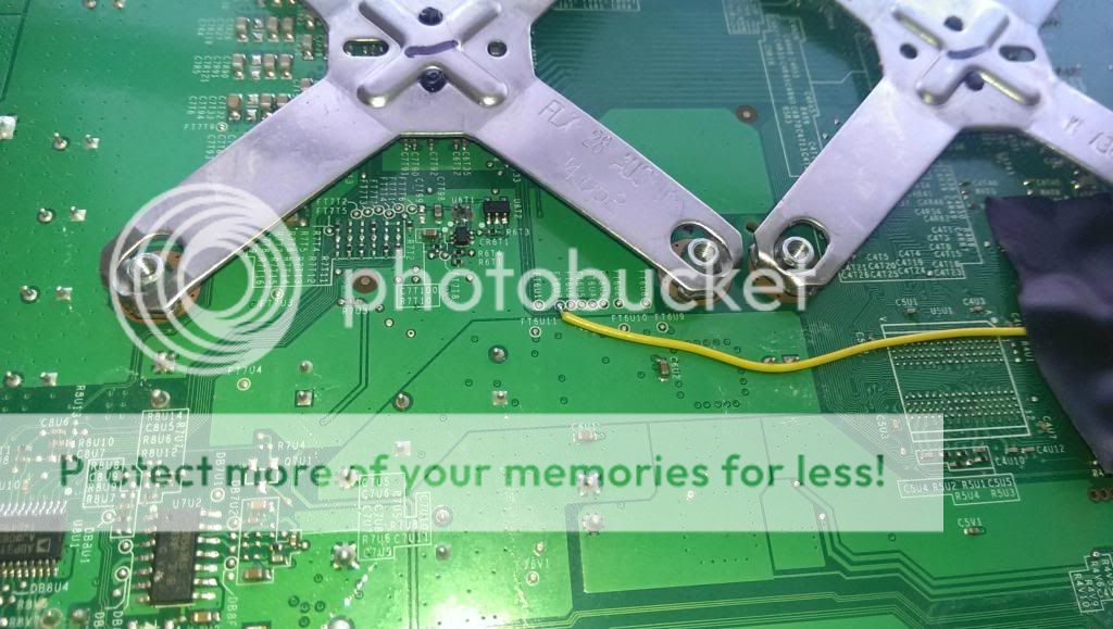

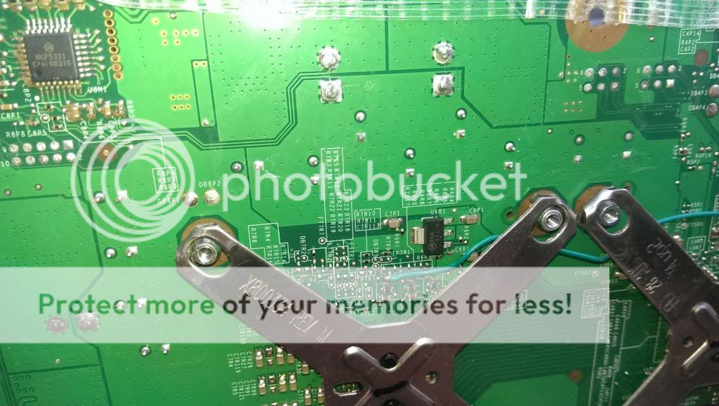

So, I got ahold of it. The chip flashes green like its attempting to glitch, but I cant get it to do anything at all.. As I dont know if it was really updated or not, I tried creating a RGH2 ecc and rewired the chip for RGH2. (And set the CR JP1 to open)... Now, when trying to glitch, the green pulse flashes VERY quickly (well under half a second long) but still at about a 5 second interval.

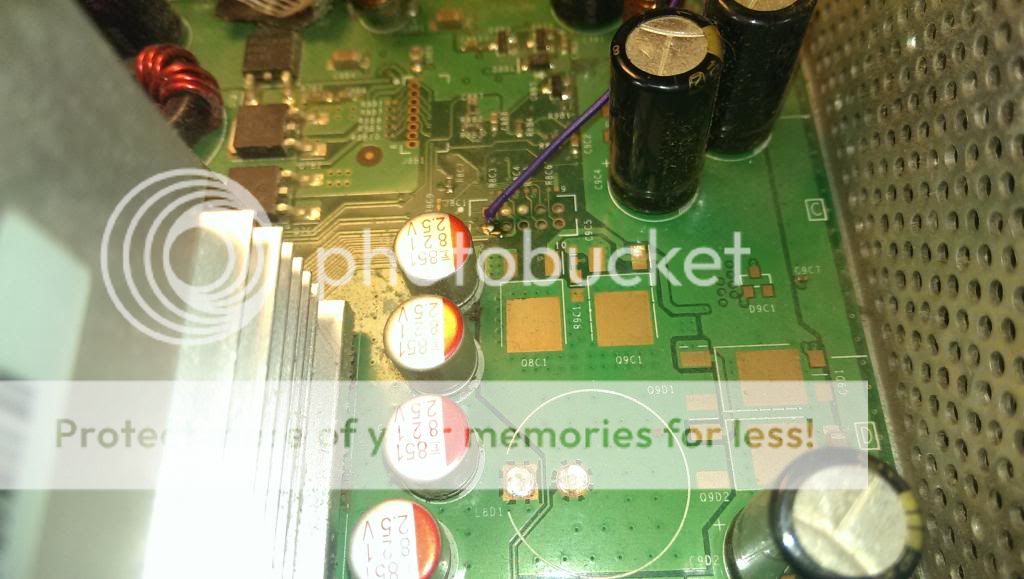

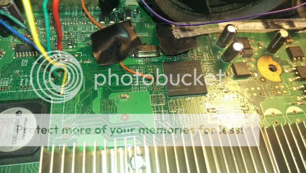

OK, THIS is interesting (And I can only assume that part of the reason it didnt work the first time was my faulty cables)... BUT, Wrote the original nand to the machine and bam... booted no problem (Chip is in PRG mode)... but, the odd part... When chip is on and ECC is written, the CR only blinks once then nothing and the machine doesnt boot. CR continues doing nothing while the front green LED keeps blinking (No DVD drive in).
I hadnt touched the wires from the original RGH install, just added the RGH2 wiring and removed wire A from coolrunner to try RGH2, then removed RGH 2 wiring when it booted to original stock...

Yes, boots to 9199, but when I write the ECC for RGH1 and have it wired for RGH1 and timing files for Falcon RGH1 all the chip does is blinks once, then nothing (still sounds like it's cycling)... but never boots to xell... Weird
Im gonna try pulling out all of my wires and redo the whole thing.
