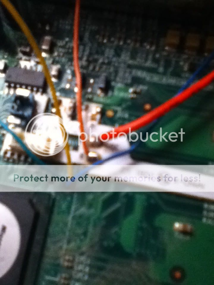

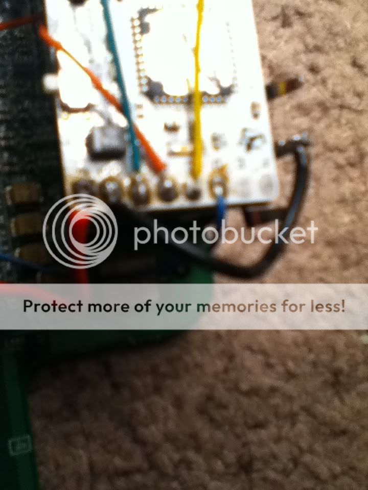

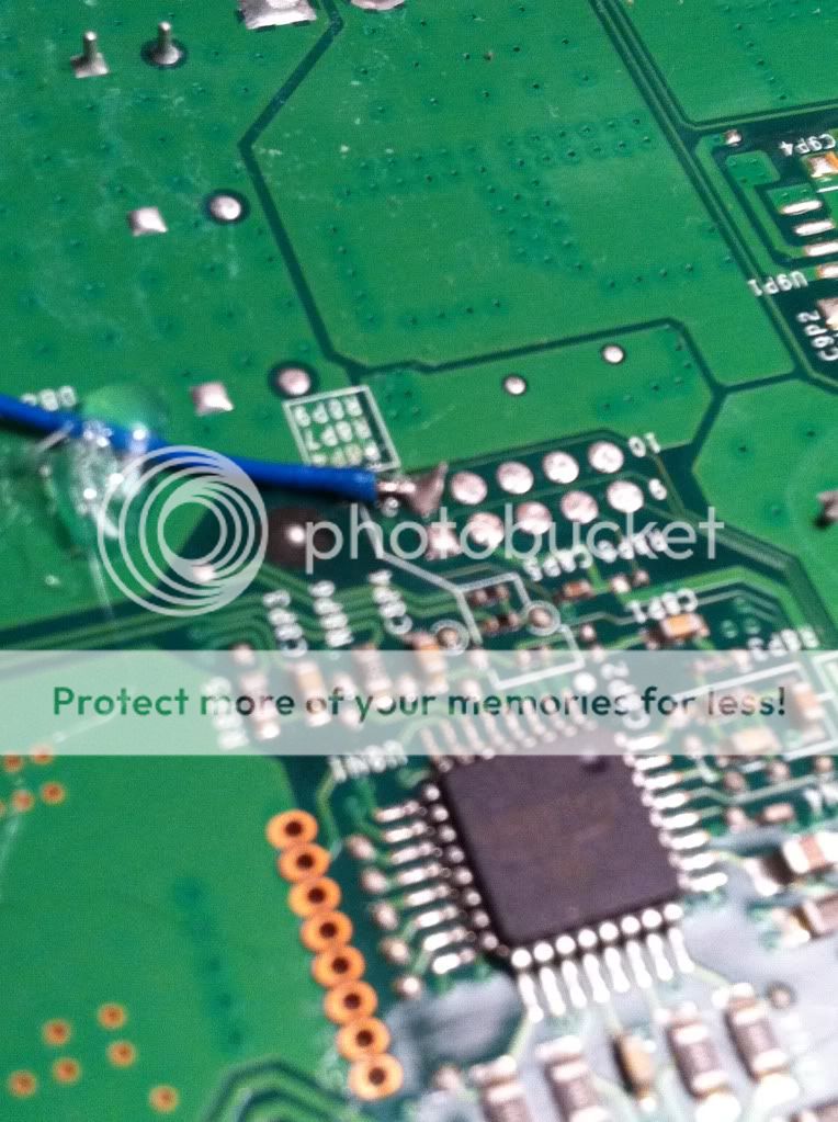

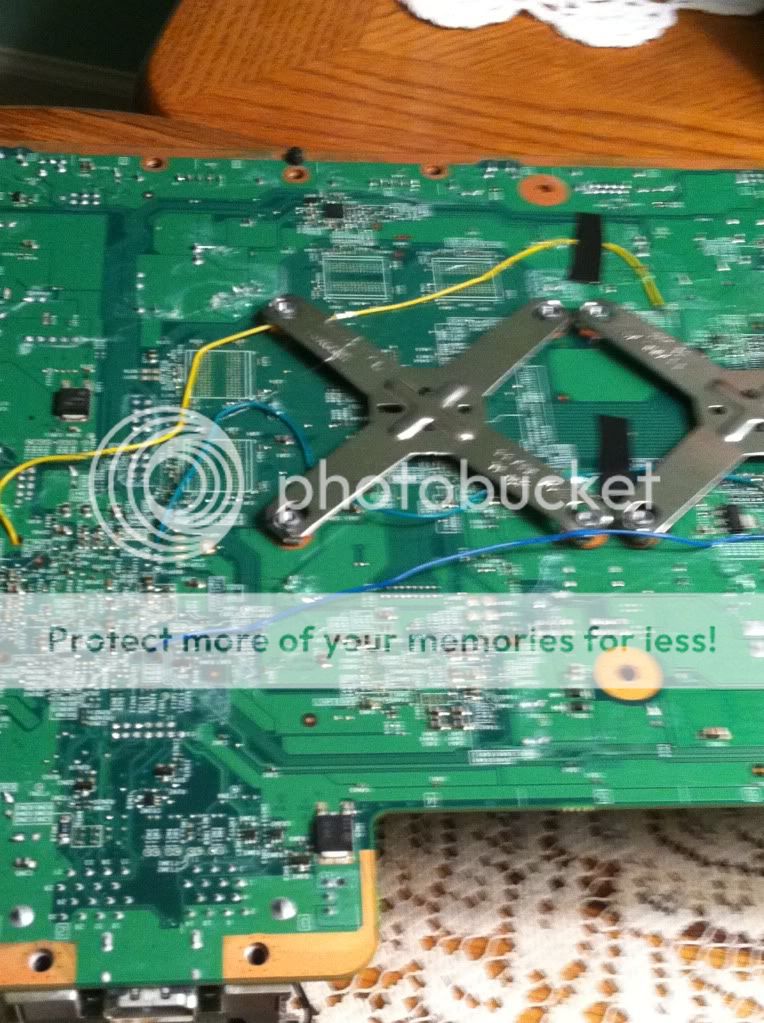

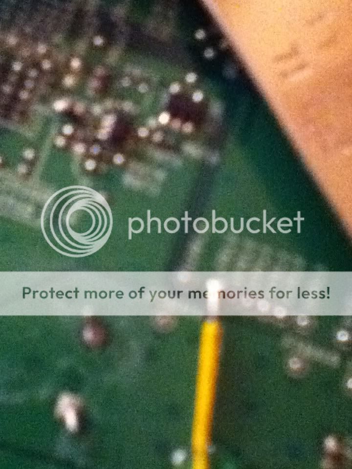

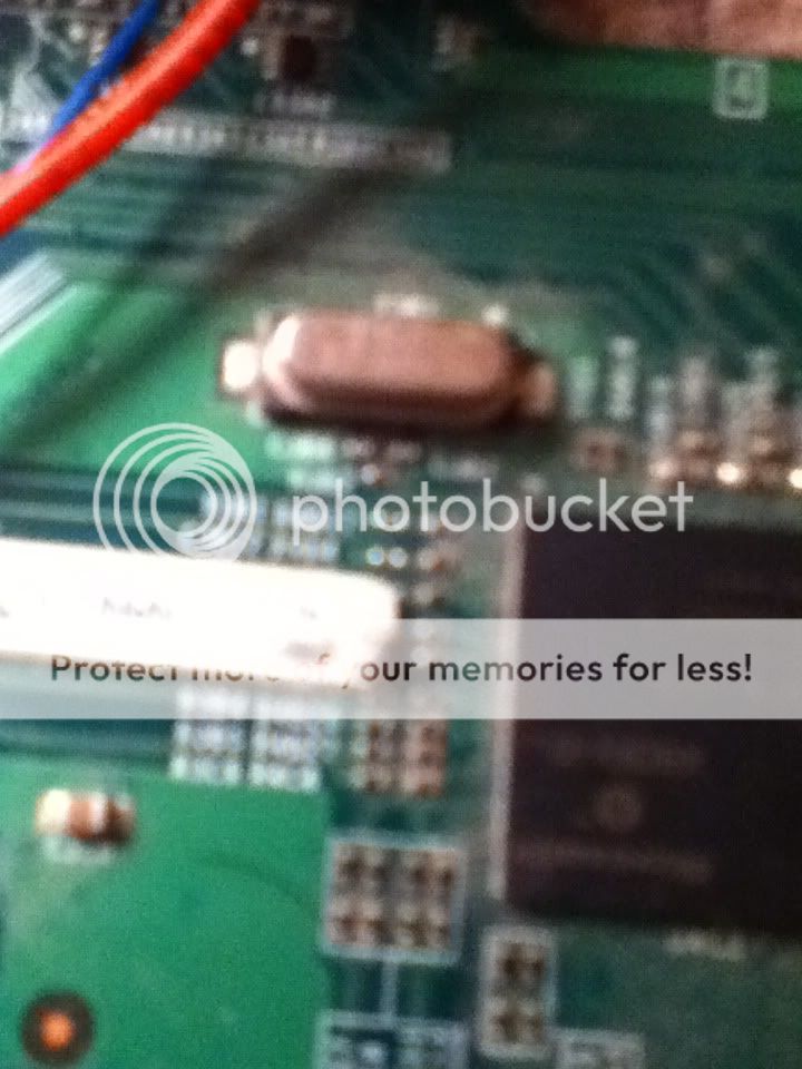

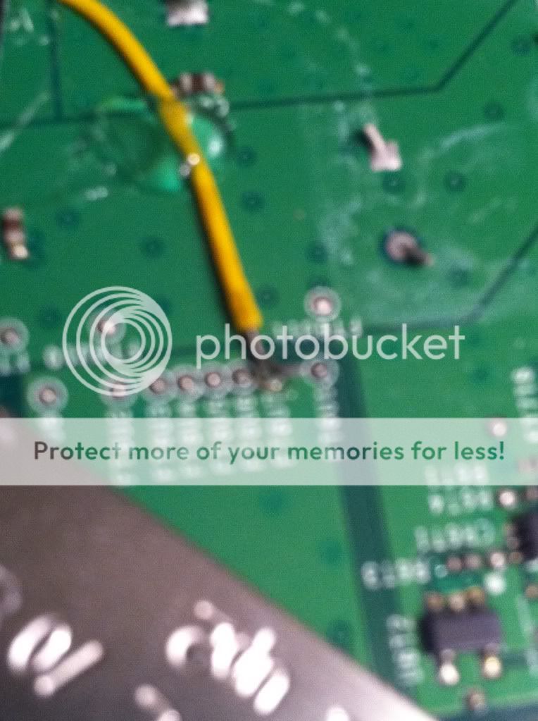

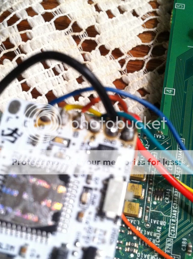

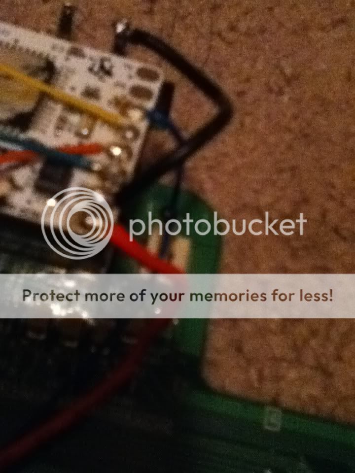

Sorry the pictures arent that great its all i got :(, the soldering is pretty good (brown stuff = flux)

tbh you really need to try and get better pics posted as it would be hard for somone to help as not much can be made from the pic so you need to get that sorted buddy
also the b point on the qsb to the mobo dont look good bit black??? like i say need better pics bud

Can you get a pic of the underside of the board for both wire routing and of the green wires solder point.

yes i used it to program the coolrunner also with the Nand-X 2 Coolrunner cable, the wires are by the x-clamps and away from the coils

please make a picture of the underside of the board so we can see how the wires run :)

also, either get a proper camera with macro zoom or better lighting as your camera phone can't focus in low light.

Why are all you pictures out of focus?
If it's blurry, take it again until it's not. Move away from the object and add more light if required.
CPU_PLL_BYPASS looks like it might be a problem, but can't tell from the image.

looks like alot of solder on PLL_BYPASS on motherboard end, that wire is pretty tricky at the best of times

trust me its not my soldering, anyway i did my 16mb CB: 6751 Jasper. Boots to Xell and Hacked Dash on 2nd or 3rd glitch. So i dont know what was up with the falcon even now after i uninstalled everything still works perfectly fine
