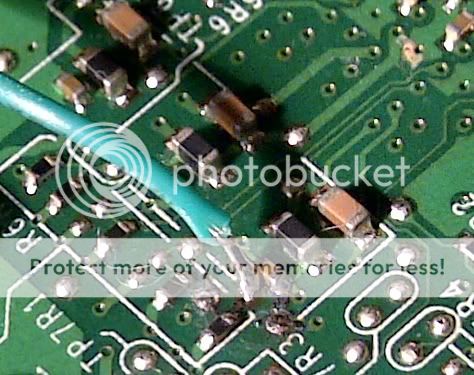

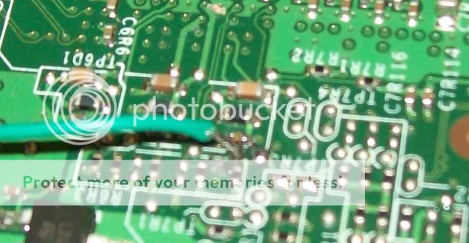

Also I took some pictures for you guys so you can take a look at my work. I am thinking it is the green wire on the bottom of the board that is the problem. It was definitely the hardest point to solder.

Try removing the extra capacitor. It's only for troublesome Jaspers, and it looks like you have a Falcon.
And you're right, the green wire could be the prob. Clean it up and use a little less solder.

Ok so I think I have fixed my problem!! The green wire was the culprit as suspected. There was a little too much solder forming a bride between another point. I used a desoldering bulb to suck up the excess solder.
After soldering the wire again I got the xbox to boot into Xell and have managed to get my keys. Lets hope I can move on from here without trouble.

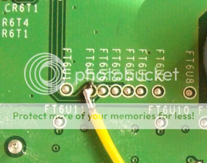

here is a few pics of the solder they are on good just was so hard to focus so close.
If I remove the grpound on coolrunner and flash back all is well boots to my stock dash. any help!

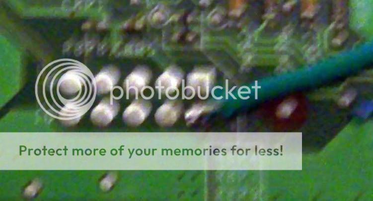

Sorry to say this but clean the flux off the green wire on the back and re-post a new pic there is to much glare to see if this is a proper connection.
ratiator
Dec 9, 2011
Here cleaned it up with a qtip and finally got the cam to focus better
I think the first time I was good as well because I had the glitch light on the board, the second time I soldered this point the chip would not glitch. So I soldered this one again and it started glitching again but still no xcell.

That soldering is not very nice.
Looks like some serious bridging of solder there. There looks like a lot of resistor movement and point joining.
I would recommend sending the mobo to someone to tidy that up and get it working. Anymore re-working on that point, and i think you will lose the resistor all together and bridge some more points
