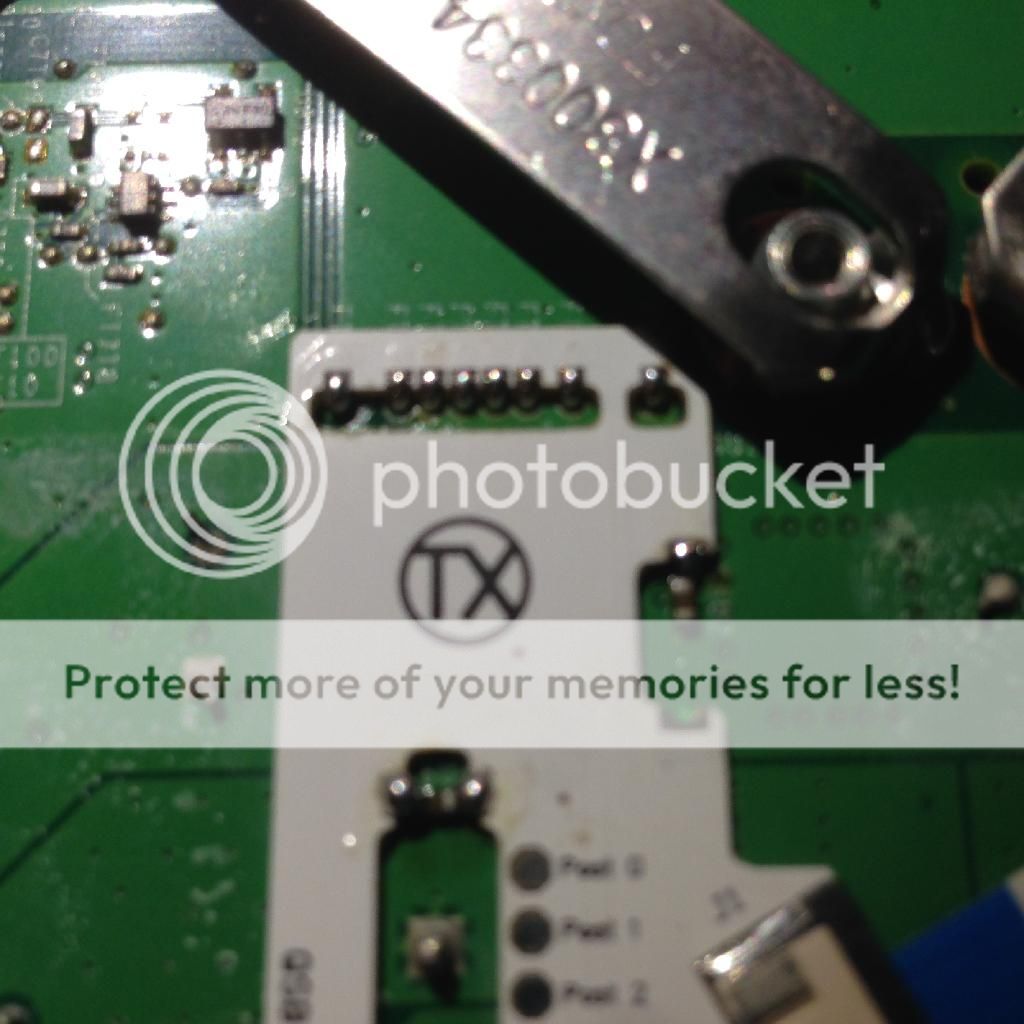

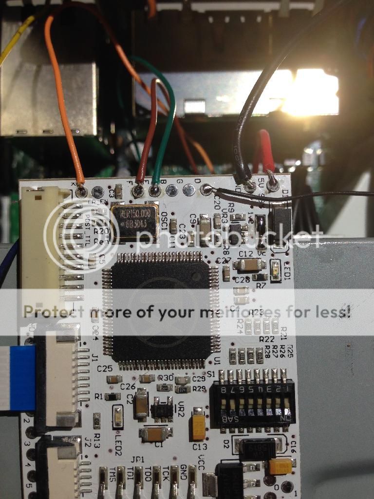

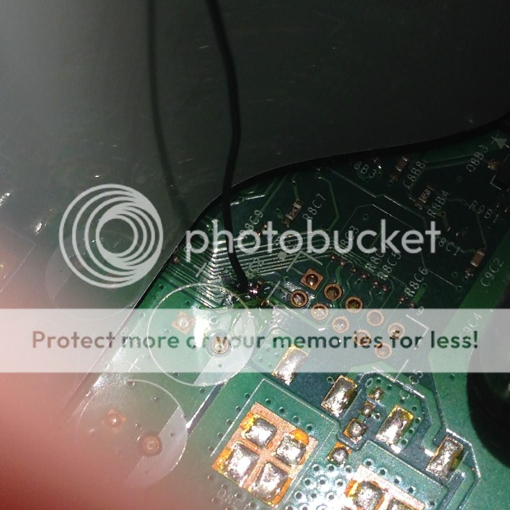

Hello I have just finished my third R-Jtag install on a Falcon. I have tuned it and gotten it to boot within 10 seconds. The only issue with this is once it boots up I can be on the dashboard for hours without it freezing but as soon as I eject the console completely freezes up. I think it has something to do with the image since it doesn't freeze until I hit eject. I am working on getting close up pictures right now. I used Jrunner to build a 16547 JTAG image WITH aud_clamp.
