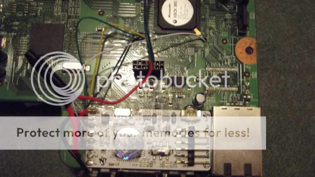

Hey everyone, I've been having some problems with my Falcon while trying to do the RGH hack. Originally, I was going to do it on my slim, but I had problems with my coolrunner not wanting to glitch, so I switched it over to my phat console (the falcon I'm having trouble with).

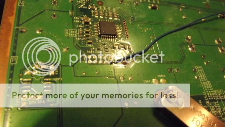

I originally tried using the QSBs for my nandx install, but the pads were torn from one of them, so I felt they were useless and opted for a different method of wiring it seen here (note: sorry my pics are such low quality. I've never had a reason to invest in a nice camera):
I used a jumper to connect my coolrunner's power and the blue and green cables for my nandx to the points to keep the install somewhat cleaner.
I know my NAND image is good because I've flashed it back and had it booting. I've been using Jtag Tool to create my .ecc images, as well as flashing my coolrunner board. My coolrunner has the constant red light, and will flash green like it's supposed to, but it just refuses to glitch?

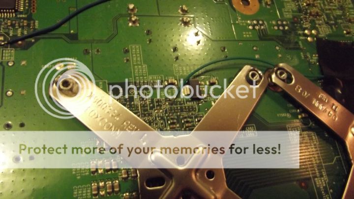

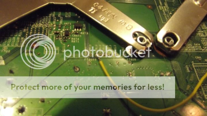

I used the alt point for the STBY_CLK point since the point near the hana chip is so tiny (it made it impossible to place the fan shroud back on without dislodging the wire).
Any help is welcomed, and if and more information/pictures are required please let me know and I will do my best to accommodate you all.
Pics of my install:
(This one was a rush... don't point it out xD )

Have you unplugged the power from the console when you programmed the coolrunner? A pic of your jumpers would be nice, it's a little blurry.
Also, I assume you re-flashed your coolrunner after reading your falcon nands?

The jumpers basically just act as a median for the coolrunner power and the nandx cables. I'll get a picture of it for you tomorrow.
And yes, I did reflash the board.
EDIT: I just remembered that I unplugged the wire for the coolrunner from the jumper when I flashed the board. So it wasn't receiving power at the time.

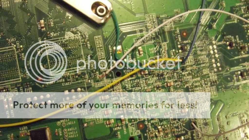

Aside from there being a history with your Coolrunner (not working on another console), CPU_PLL_BYPASS has too much exposed wire.

In which case I would be tempted to find someone local to you who does them (if possible) and get them to have a look. It may help you isolate the cause. Little things like the rate of the debug light flashing, its duration lit etc might help. It may even be an issue on the coolrunner itself after previous attempts.
EDIT - can you get a closer image of CPU_PLL_BYPASS?
