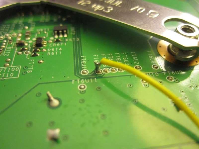

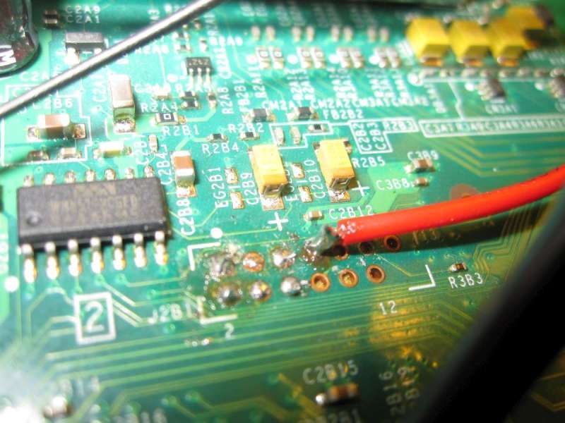

Here are the pics. The 3.3V wire looks a little ugly, but I had trouble sending solder up enough to level with the surface of the mobo. I actually soldered a wire from a capacitor (I snipped the cap itself off, just to use the leg) from the bottom up through the top so the 3.3V wire (red) had something to attach to.

Wow those are some great pics! Perfectly clear.
Your Soldering looks a little wild but not the worst I've seen. Go ahead and change the thermal paste out. The fans speeding up isnt typical for an error in installation of the coolrunner. It useually points to bad contact between the heatsinks and the chips. I.E. to much thermal paste or not enough.
