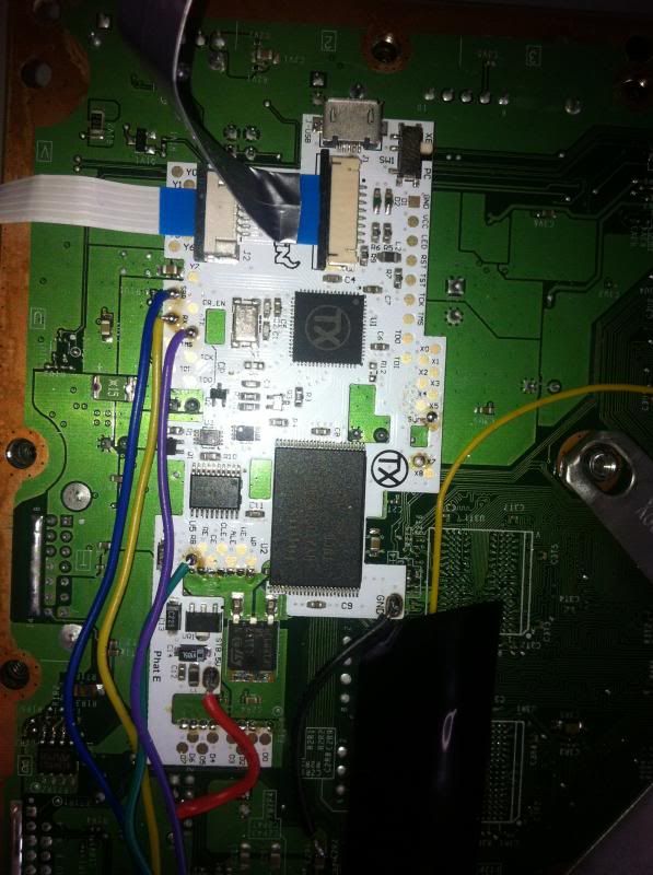

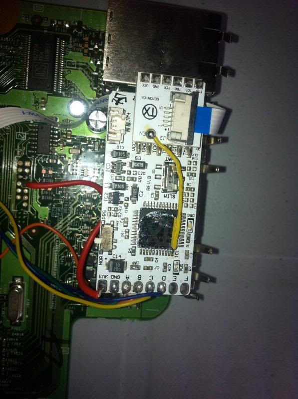

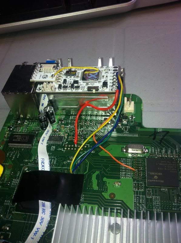

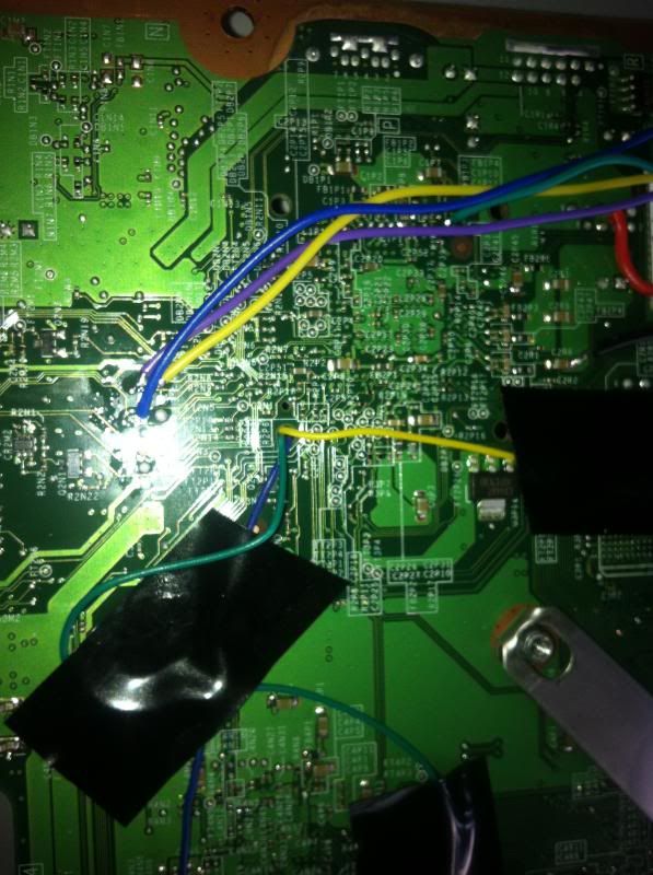

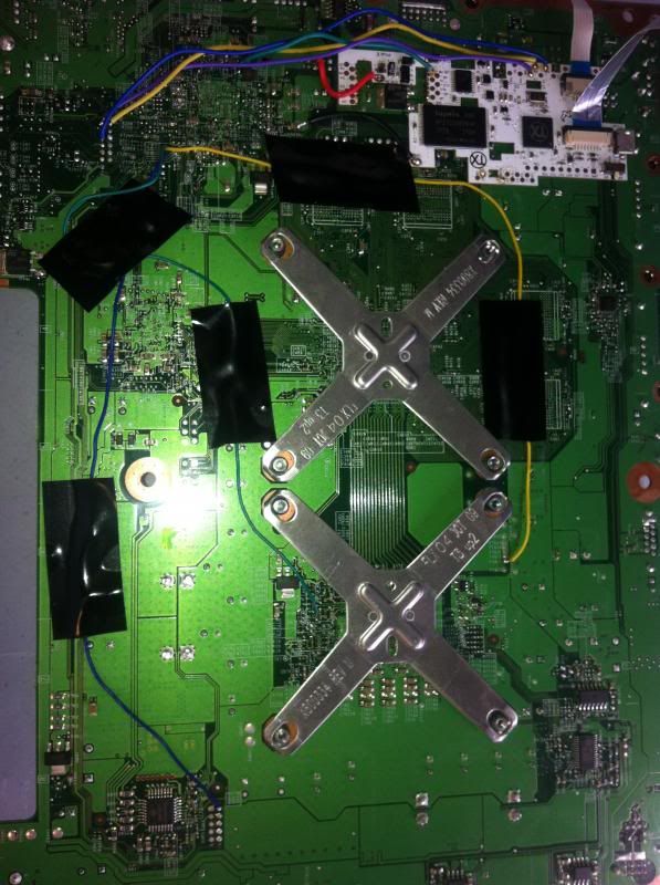

So I have a 14719 Jasper fat model that was glitching great with a Coolrunner RevB using RGH1
What i've done:
1.) update demon to 1.04 by direct microUSb connection to PC using the demon toolbox.
2.) soldered in demon according to Uber's guide
3.) I did NOT solder on the Sync wire (therefore i can still switch nands but with the button on the demon daughterboard instead of the Sync button - right?)
4.) I did NOT solder on the Remote Power conneciton wire (I'm a little unclear of what this wire does - Does it let you power on the Xbox 360 differently)
5.) Connected ribbon cables.
Questions about Demon Use and testing:
  1. can my demon be used in conjunction with a rev B wired for a RGH1, Becuase all the pics and vids i've seen are wired with a RGH 2.0
  2. For updating the demon in the future, the demon switch I left on "XB" and I should be able to plug into the USB daughterboard to the PC and give me access to the hardware correct? Should the Xbox 360 be plugged into standby AC Power like when you're programming a nand for a RGH? (i don't want to damage the demon is why I'm asking).
  3. When the Blue lights are ON on the dongle at the front - that means the Demon is enabled and you are running the Nand programmed to the demon right?
  4. the original RGH wiring for the Coolrunner should all stay the same right? Nothing needs to change there?
