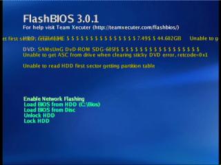

I am flashing using the http method. I see the yellow, then the green and shuts off. i turn it back on and it show the bios screen again...what could this problem be

are you flashing the x3 bios? and have you changed the dip settings correctly

sounds like you flash the chip with the flashbios 3.0.3 instead of the x3_1959 bios.
get the x3_1959 bios and flash the chip. simple
