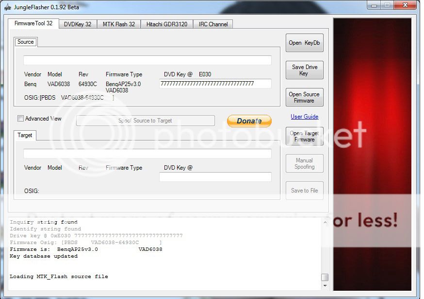

I don't know if this helps at all but this is the screen I had this morning. Afterwards, I put in my retail game and it played properly.

What in the world type of fw is that?
It must have some strange, third party modded fw on there.
Definitely upload your fw dump, Martin C or I can parse it manually.

Code:
Offset(h) 00 01 02 03 04 05 06 07 08 09 0A 0B 0C 0D 0E 0F
0000E010  FF FF FF FF FF FF FF FF FF FF FF FF FF FF FF FF
0000E020  00 11 22 33 44 55 66 77 88 99 AA BB CC DD EE FA
0000E030  77 77 77 77 77 77 77 77 77 77 77 77 77 77 77 77
0000E040  FF FF FF FF FF FF FF FF FF FF FF FF FF FF FF FF
JF is looking in exactly the right place.
0800 should not be used in a console, nor do consoles ship with it.

Oh,
md5 confirms.
Loading firmware file C:\Users\Oggy\Downloads\Benq Log and OFW\BENQ-OFW.bin
MD5 hash: 31b7a19fa0e92c27060a77bb0cf37fcf
<3 JF
