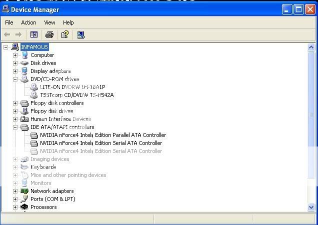

i have updated my nforce 4 sli sata drivers going to try again. I am ordering the via 6421 PCI to sata card online if anyone has xfire please add me INFAMOUSKILLER capitol letters<<==

The 2nd rig I use for flashing is nforce 4 but for me to do this I had to uninstall the nividia drivers and let windows install the standard drivers for this to work.

going to try to erase the sata drivers and let windows replace them try that see if that works.

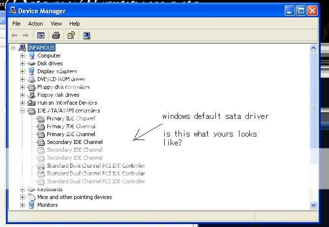

going to try with windows default sata drivers
last thing before i purchase a pci to sata card

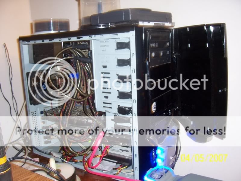

Im just throwing this out there(i couldnt see it in your pictures)
I think you need to use the molex power from the pc to power the blaster. Then you use the modeb button on the blaster to put the drive into modeb.
I do not have a blaster but i have look at it and it seems thats how its supposed to work.
EDIT: now that i watched your video i see that you are powering it with molex power cord. Just use the modeb button on the blaster. And make sure you have that little swith(for samsungs) disabled.

ok well it doesnt say anything about a spinning disc like it should did yours not do the spinning disc thing
