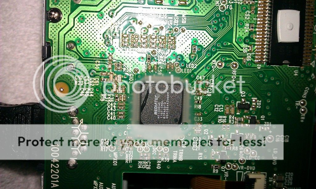

should i continue or stop? I'm not putting any pressure just letting the weight do that for me but after 4min i'm feeling very paranoid about going further into it. I'm using the drill bit that came with the maximus template
13,721
Assuming you are drilling in the correct place (the template is pretty accurate), JungleFlasher will beep once the drive's SPI is unlocked successfully (AS SOON AS YOU HEAR THE BEEP - STOP!).
However, since you haven't got 3.3v connected, I recommend taking it very slowly so you don't drill too far which would result in you going too deep, severing the wrong wire.

I've just read that the drill bit with the maximus is simply for marking and not for drilling. should i check the hobby store for something smaller or even pick up an exacto knife? Also in some cases could JF not beep, which would have me to power cycle every couple turns?

hope you've got your key before you started drilling !
i'm guessing your Kamikazing the 0401 drive

oh yes of course i got the key! doubt i hit any traces but ill start again tomorrow with a smaller more precise bit.
