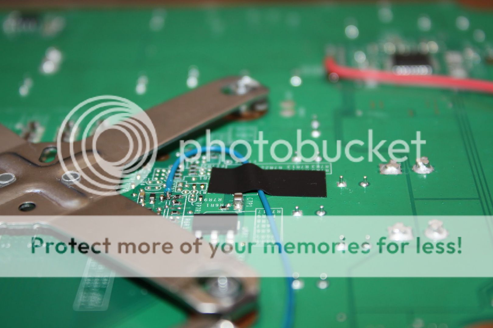

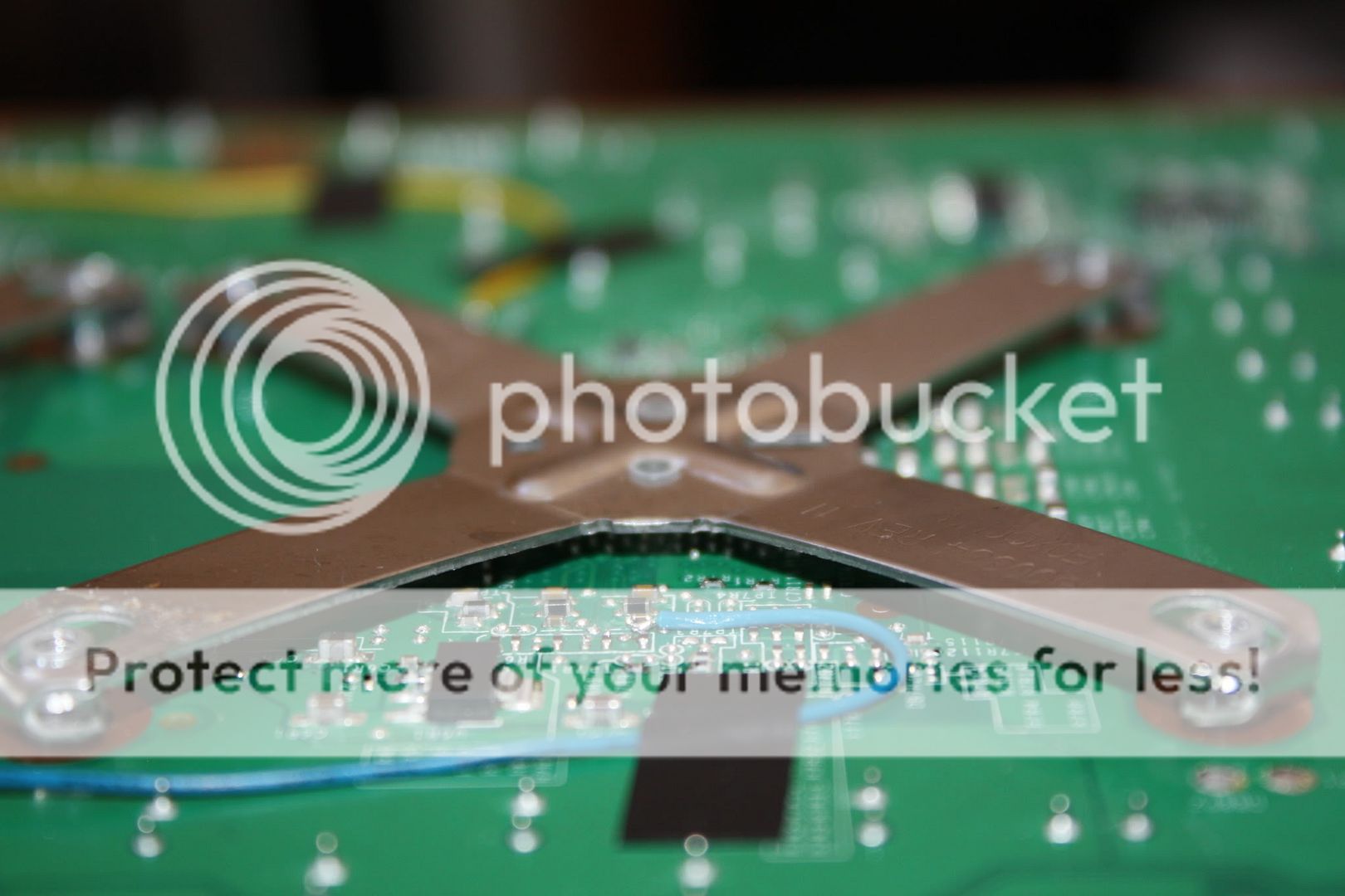

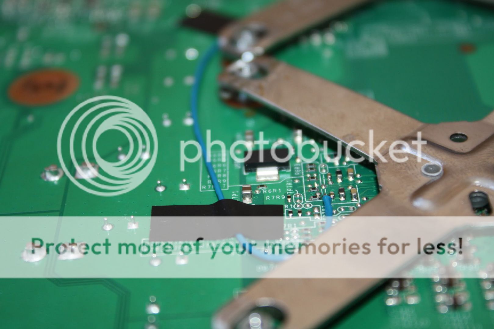

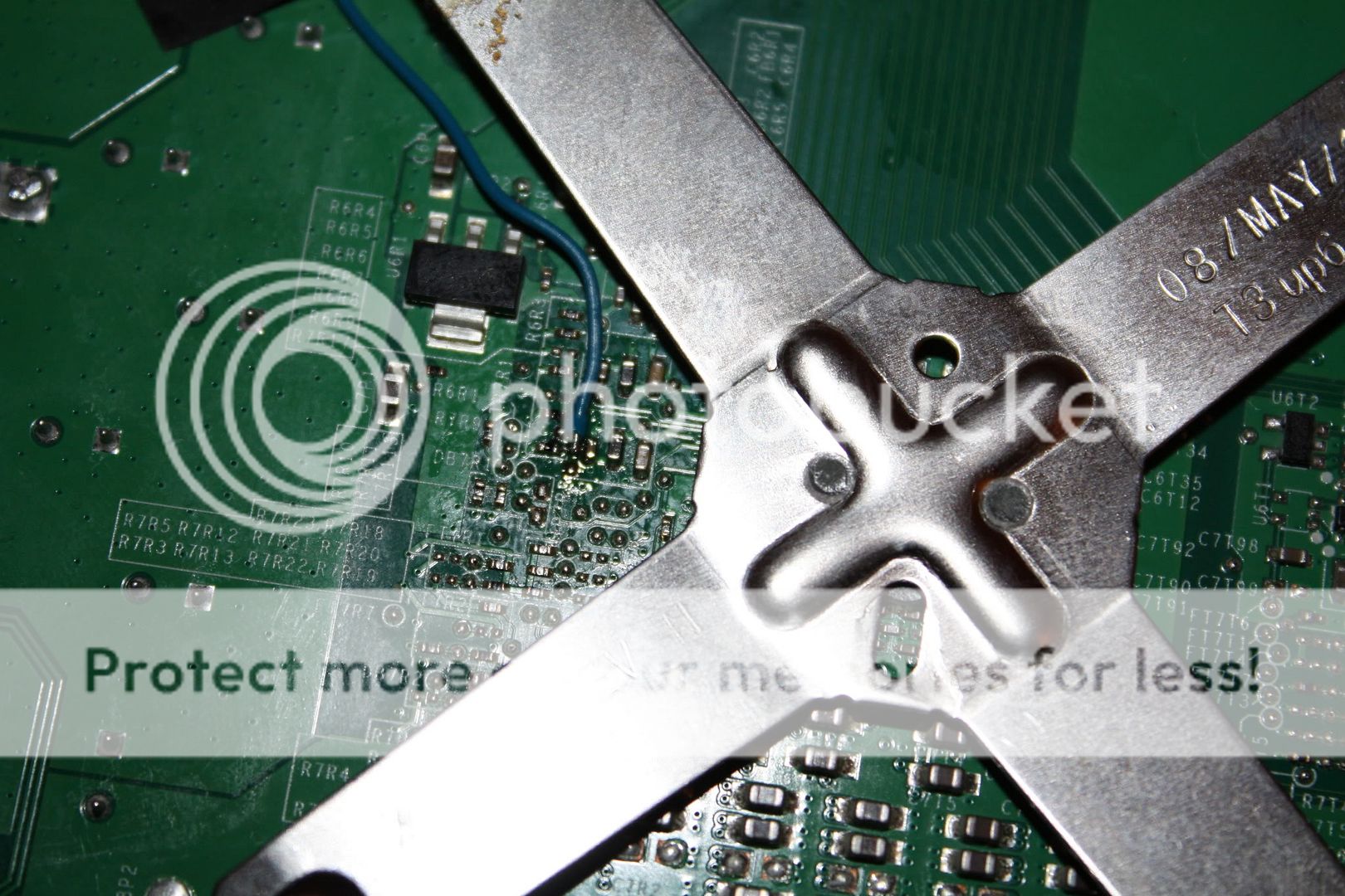

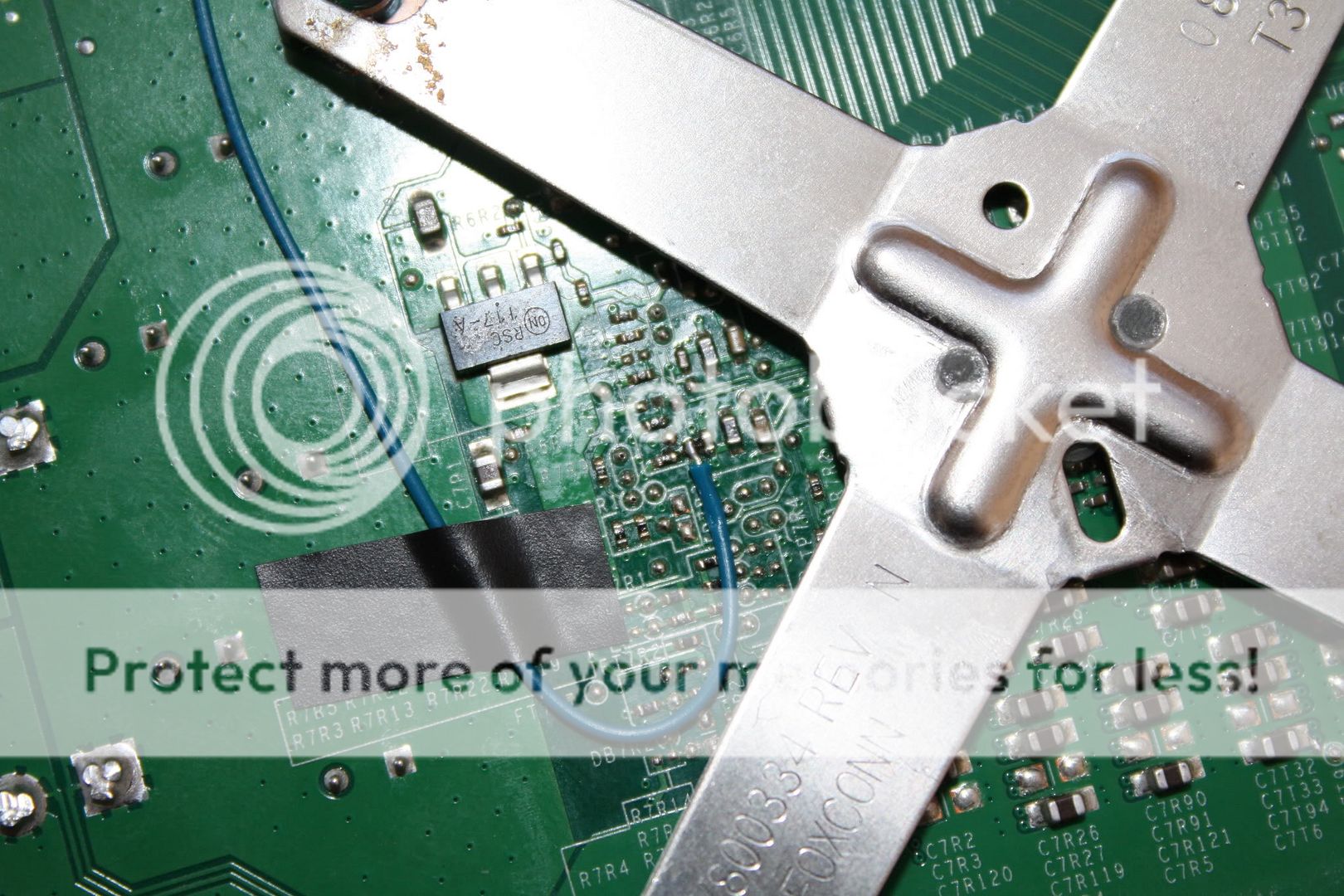

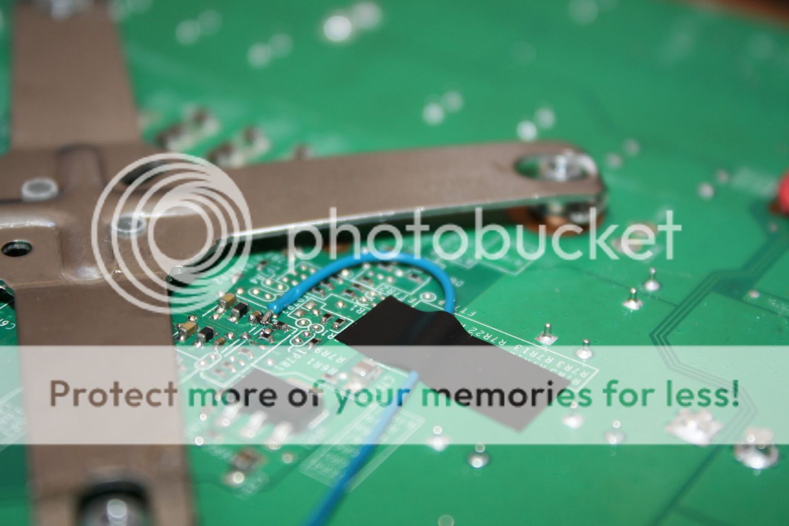

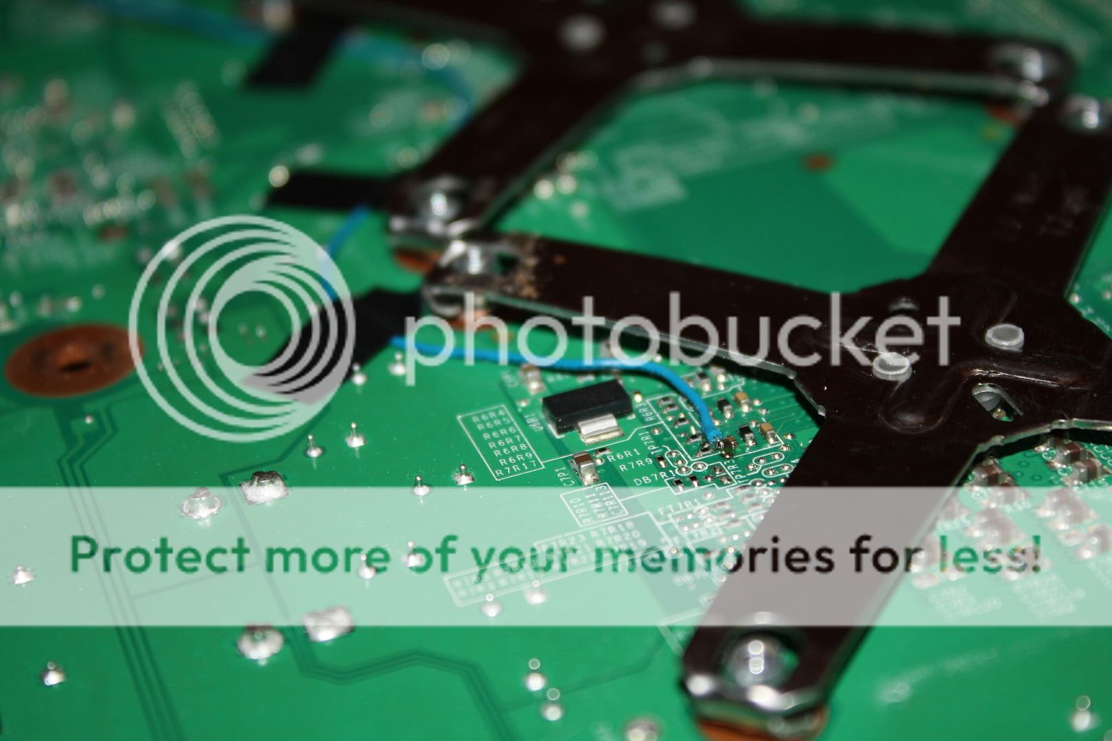

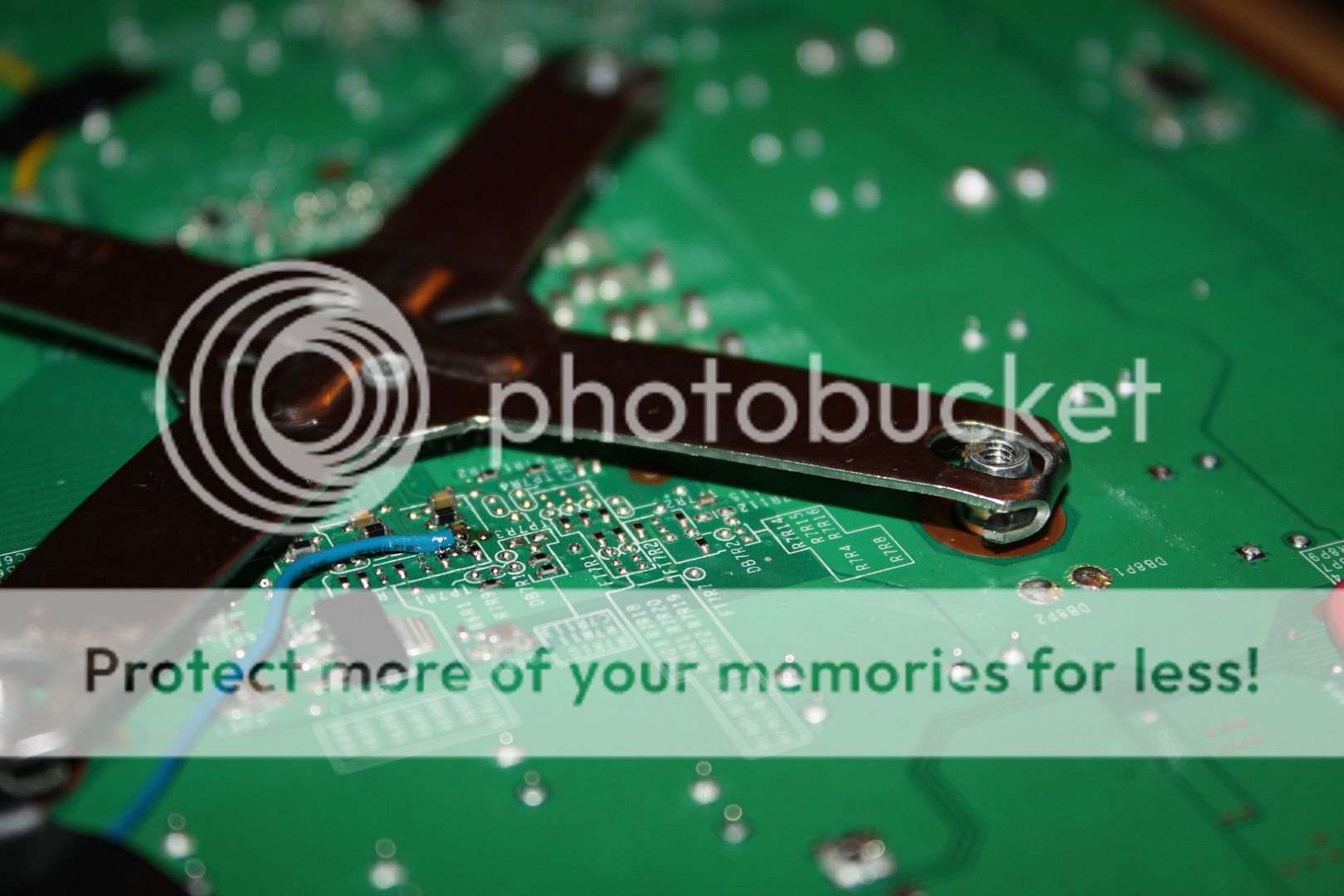

Sorry martin, just got home. Here's some pics.
I tried the default wiring as well with the same results.
I was just trying the blue wire in different spots.
Everything looks good and it's booting in NOR mode. You don't need the CR connected to the console in PRG mode so don't worry about it. I was more concerned you had a short, but all looks ok.

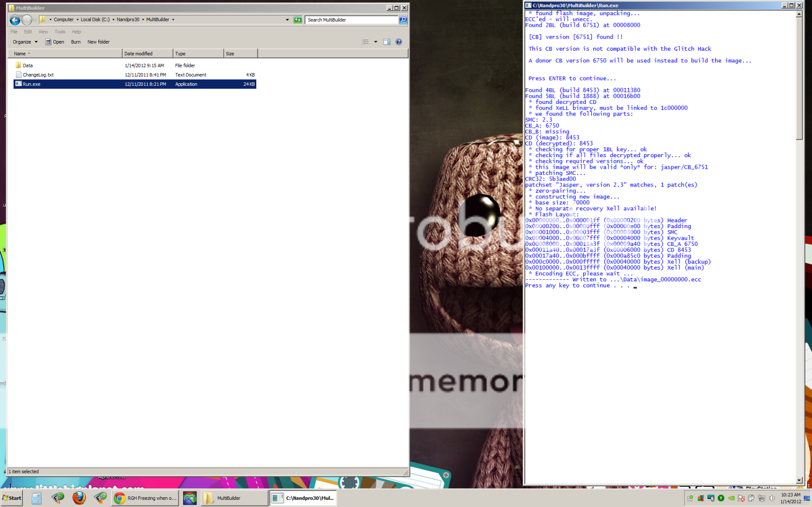

I finally got back to working on this rgh. After I make the ecc file. I get 2-3 flashes and it stops. No xell though. I am using multibuilder 0.7 and cmd (nandpro usb: +w64 image_00000000.ecc) to flash. I have tried multibuilder 0.2,0.4, and 0.6 as well.
If I reflash orig nand it boots just fine. Wiring and soldering are still same as above pictures.
Here is a copy of my nand as well.
Nand Image

The reason I asked for more pics is there's a via that's right under the insulation which goes to GND and I thought it's was a little too close to the exposed wire.
Desolder the green wire, trim about 1mm from the end and solder it from the other direction.
Look at pic #2 in my sticky here:
http://www.team-xecuter.com/forums/showthread.php?t=79402
