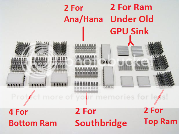

These came with the heatsinks and I'll be putting them on today, The thermal tape is crap on them so I'm replacing it with 3M.
Will prob replace all of the inductors with falcon inductors because they lay flat & will make it easier to tighten heatsink bolts.
After that I'll be searching for a better thermal compound, quiet 120mm slim fans & some tall enough standoffs for the motherboard so I can use the ram sinks on the bottom. Then I will have to think of a case mod for it.
Will also be adding a TX Phat Sonus when I remove the heatsinks to change the TIM.
