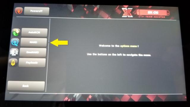

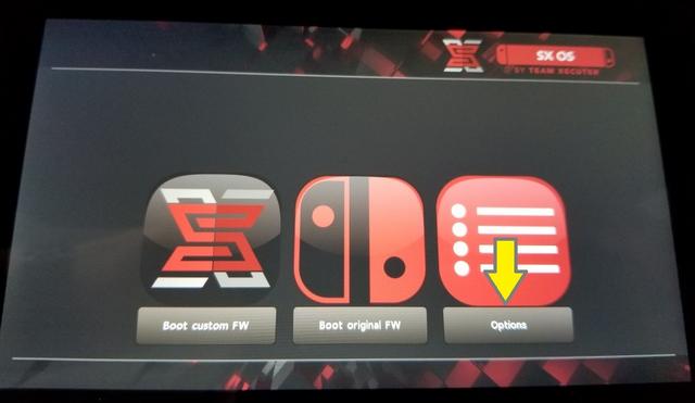

Hold Vol+ while booting to enter the SX OS Bootloader and tap "Options"
Tap the NAND button on the left

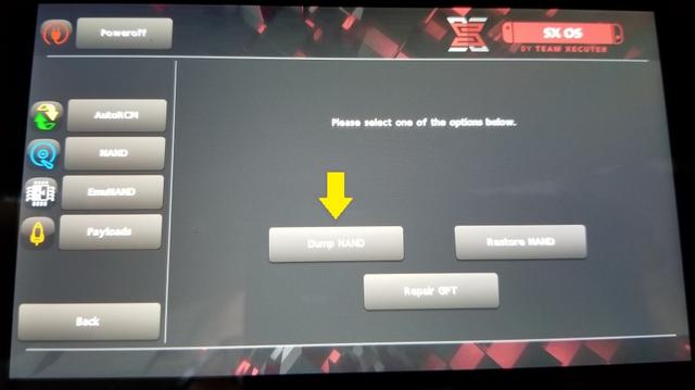

Tap Dump NAND
Tap on Continue
As stated on screen, dumping your NAND will take about an hour. So plug your switch into power and go do something else for an hour. (This took 1 hour and 14 minutes for me)

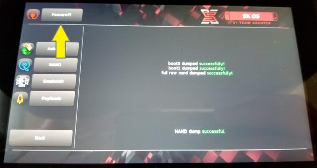

Once the backup is completed, tap Power Off
Take your SD card out of the Switch and insert into your PC to make a copy of your backup.
The backup is created in a folder named "SXOS". Open that folder and you will see a "backup" folder. Copy this folder off of the SD card and store it in a safe place. Make multiple copies and store in multiple places. If you ever need a backup, you don't want to lose this.

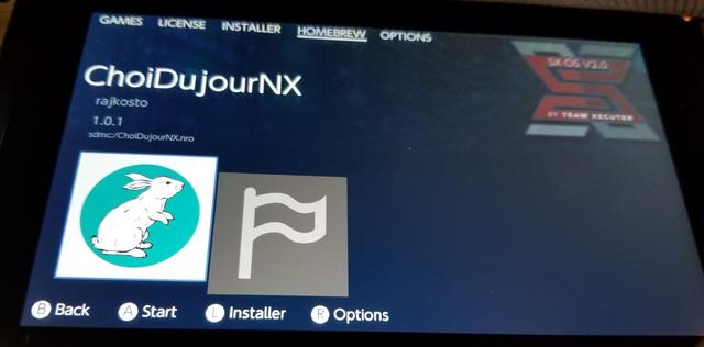

Put your SD card back into your Nintendo Switch and boot into SX OS CFW.
Open the Album to trigger the SX Menu.
Use the "R" button to navigate to the HOMEBREW section.

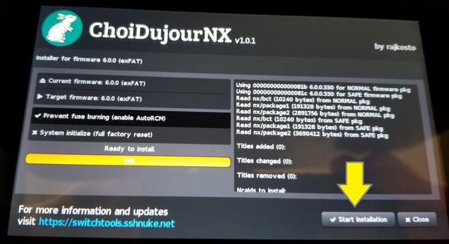

Launch ChoiDujourNX.

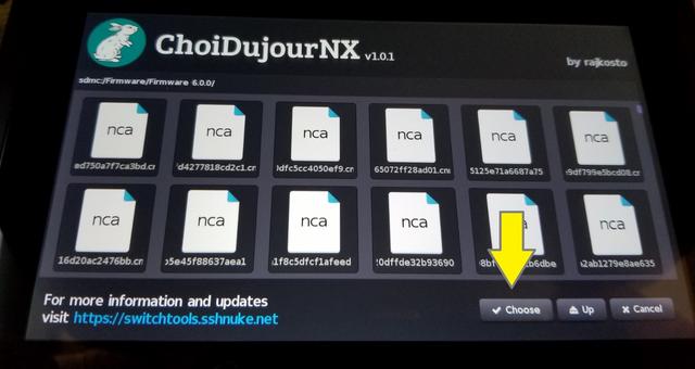

Navigate to your firmware folder, it should contain a lot of .nca files. Tap the Choose button

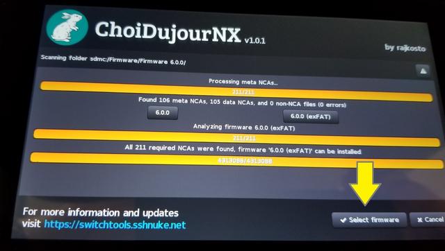

Tap the (exFAT) option for your firmware. Unless you have a very specific reason not to, you should be using exFAT for the best compatibility and support for files larger than 4GB
After the software is finished analyzing the firmware, tap the Select firmware button
Tap Start installation
WARNING - IF ENABLE THE SYSTEM INITIALIZE OPTION IT WILL PERFORM A FULL FACTORY RESET! YOU HAVE BEEN WARNED!!!!!
If you do happen to erase everything, just restore your nand dump.... that's the whole reason it was created to begin with.
--- You will see in my screen shot that I am already using firmware 6.0.0 and the target firmware is also 6.0.0, so your screen may look a bit different. ---
