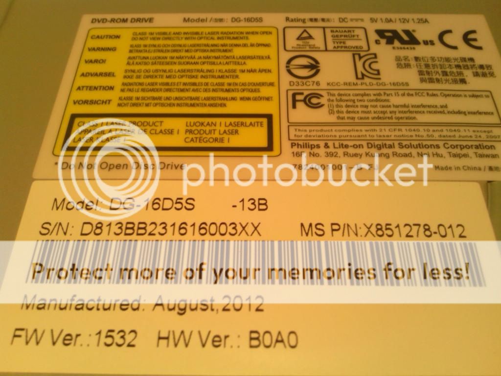

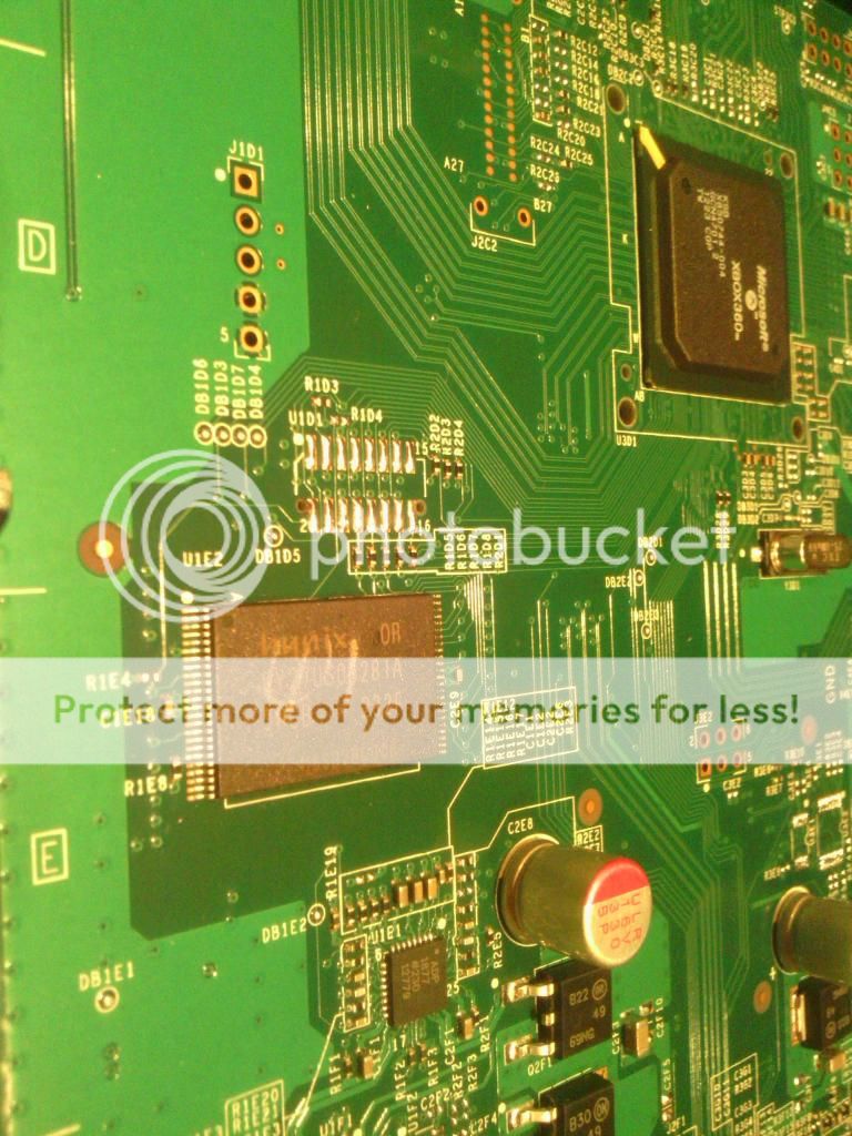

Hi guys i have opened a Xbox 360 Halo 4 special edition. It looks to me like a Corona V1 mobo but i could be wrong though. I dont know if these pictures are enough to say for sure. Any help would be appreciated
Build date: 2012-08-31 :MFR date
DVD Drive: Lite-On 1175 DG-16D5S
Thanks in advance :)

I just solderd the wires like you would on a normal corona V1 i got bad blocks tough wich i never had before i dont know if that could have anything to do with the unbridged resistors or just bad soldering.

I opened it back up again here is a close up from the resistors.
Yesterday i did a console it had 3 resistors missing and it wouldnt dump at all untill i bridged the 3 resistor pads. (MRF 2012-07-24)
This one dumps fine but DGX does nothing so i asume its missing the Post out i cant say for sure because i dont have the X clamp removal tool yet. (MRF 2012-08-31)
I just ordered everything i need :)

You will need to bridge the points were the resistors are not there to get the dgx to work, correct me if I'm wrong
