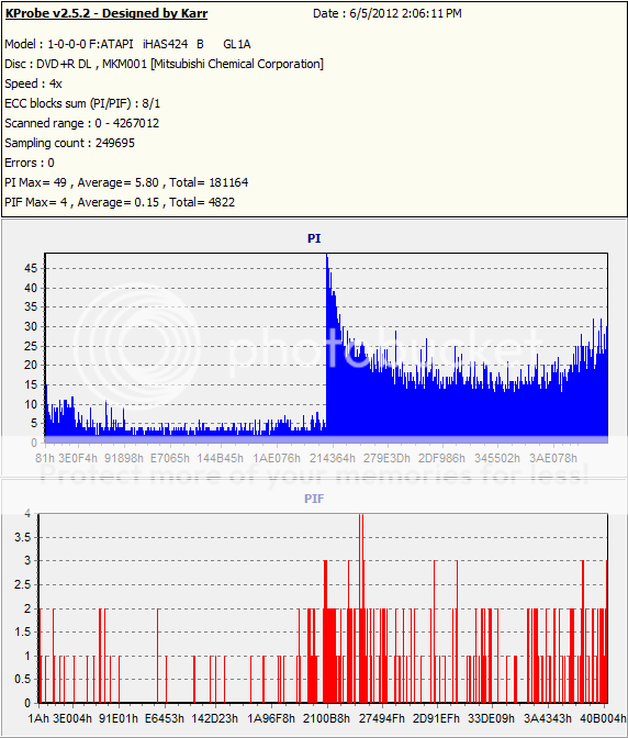

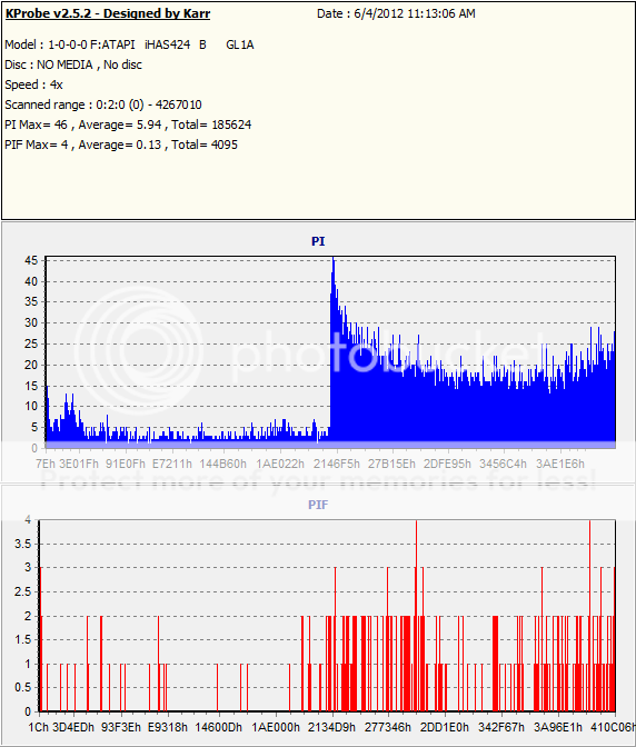

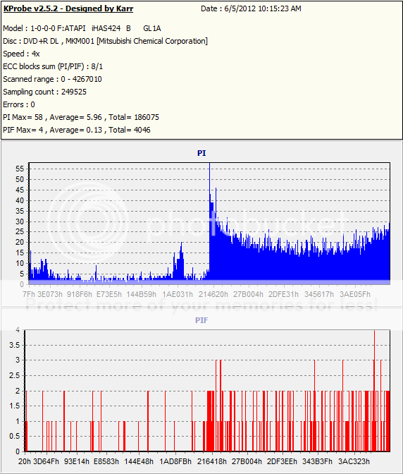

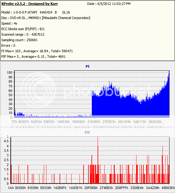

My current settings have been:
OPC - OFF
SB - ON
FHT - OFF
OS - ON
OHT - ON
I have a iHas424-98B and it started out with having really low PI, but PF would be higher than the recommended
These are the last few burns on MKM-001 singapores burned at 4X
MobbDeep
May 26, 2012
9
Yeah.. I've been trying different settings from threads like that for the past few days. I still can't get it to drop. 2nd layer kills me everytime
