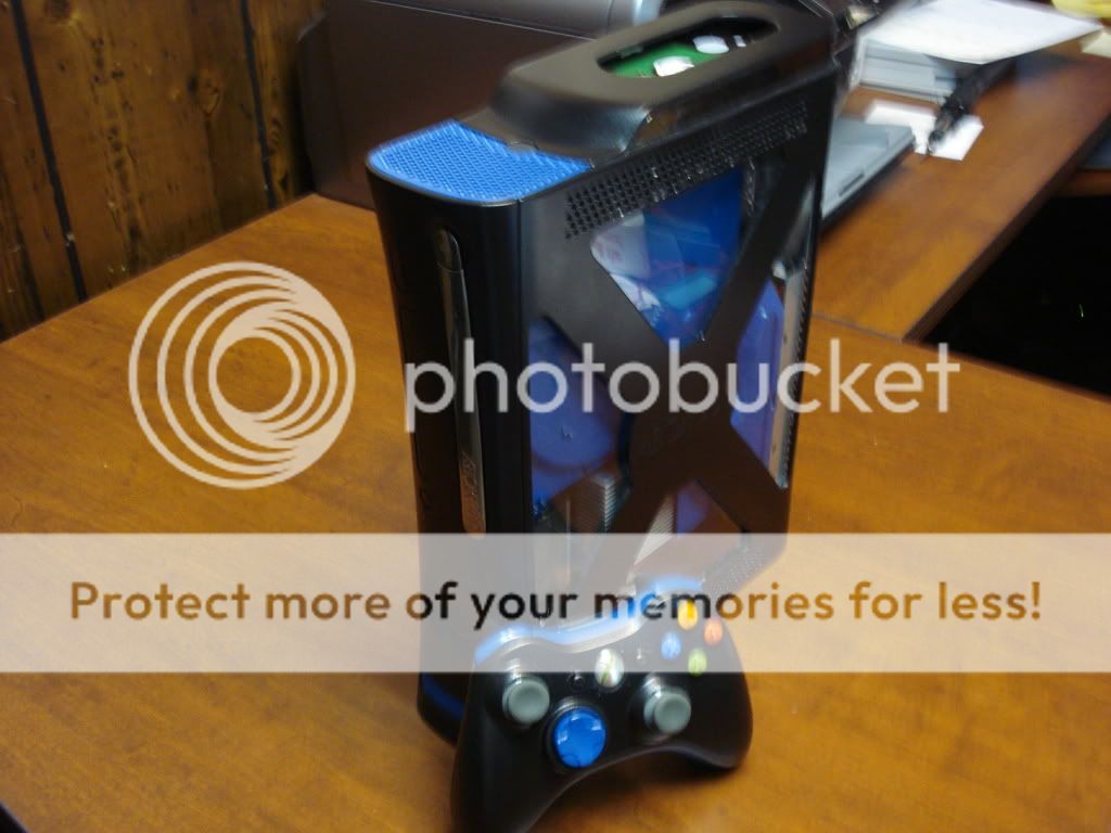

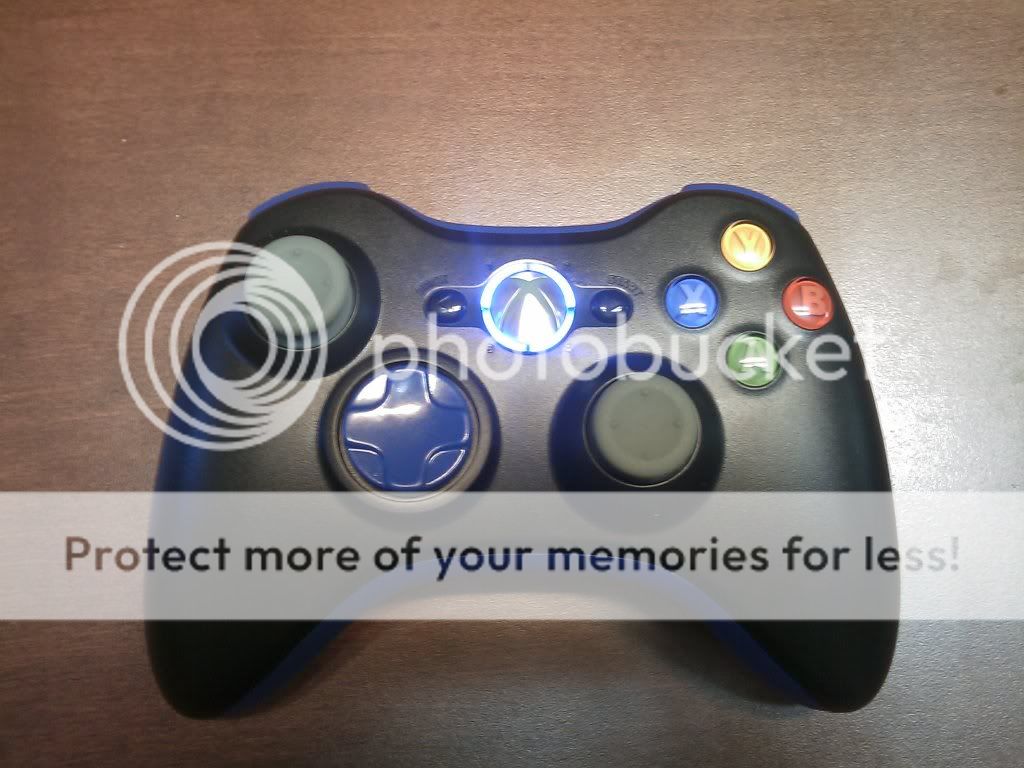

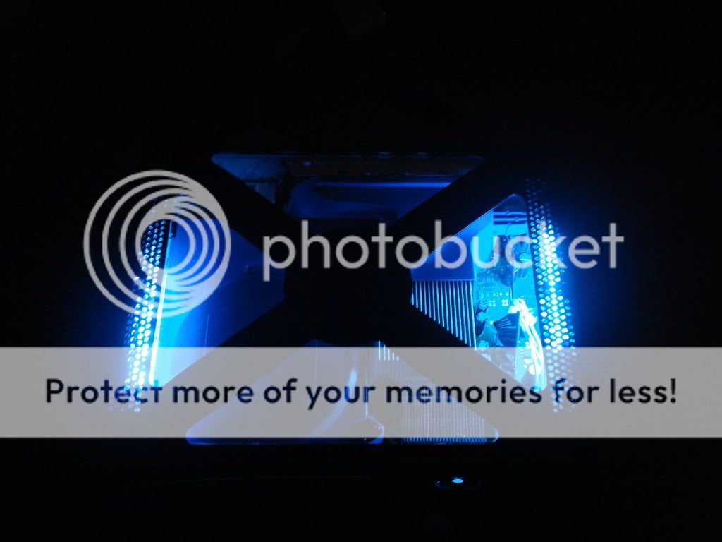

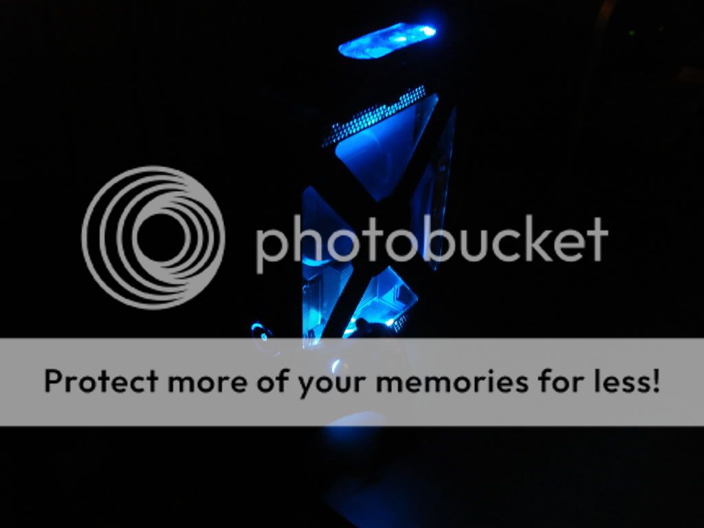

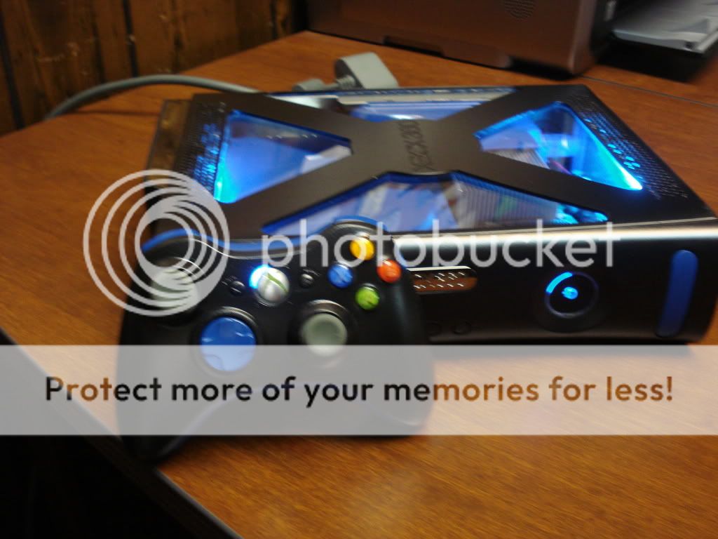

Just finished my first case mod was bit tougher than I thought there's a lot I would do different next time but here it is let me know what you think :D
No rapid fire I don't cheat

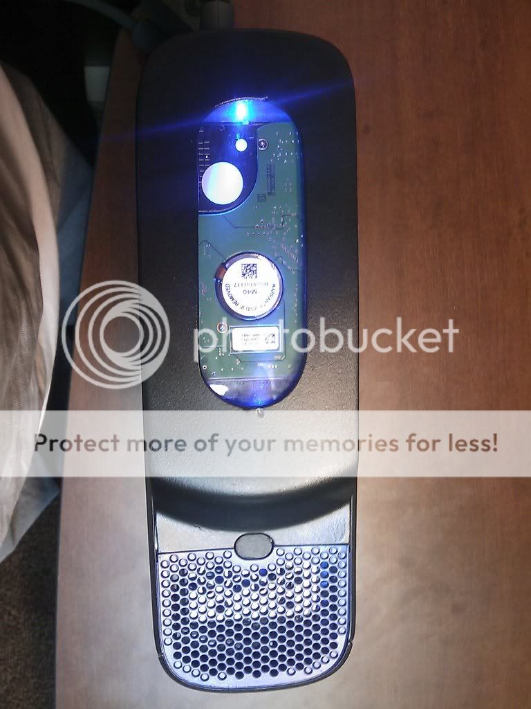

Hard drive mod
Used 4" cold cathode lights for the inside but should of made my own array with LEDS this blue is to light

this is very nice i really like the blue and black color scheme. the only thing i would suggest is some kind of filler (like bondo ) for the nicks in the hard drive case. still a great job, yet another great case mod for the site.

dude you did one hell of a job for your first time modding. cuts look very smooth, paint is nice. What brand paint did you use?

Thanks :D yea I wanted it to match my PC that I built a few months ago which is black with a window and blue lighting. I kinda messed up on the hard drive I did that cut free hand thats why I have those cuts from the dremel, I didn't want the window that big and I have bondo but I don't know why I didn't use it and I didn't want to repaint afterward. For the paint I used rustoleums ultra cover 2x but I think next time I'm going to use the stuff made for plastics though like krylon fusion I heard that works really well. I don't know if it was me or the paint but I felt like when I was painting it wasn't even some spots looked more wet than others but after it dried and a coat of clear it looks ok.

the paint is very nicely done i agree i would not mess with it just for a couple of nicks. sorry if it sounded like i was knocking it just a friendly suggestion.

Very clean man...nice job for first time...vinyl fabric dye works great too if the color scheme is simple. Leaves a silky finish just have to clear it real good to get amazing results.

looks great!! maybe a dvd window would top it off? I like the window design also

Thanks...... maybe I'll try these on my next mod....and any suggestions/comments are appreciated thanks again
