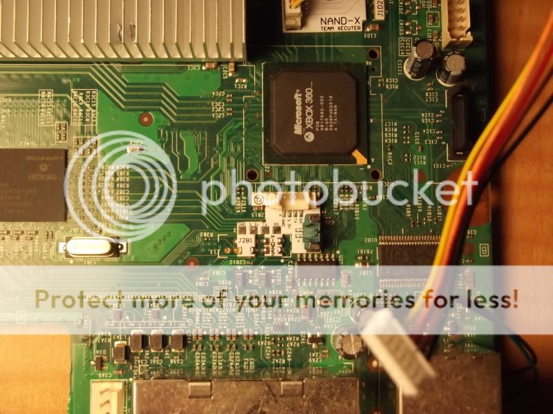

ok thanks guy! now im installing the coolrunner and dont know where to solder the orange wire (STBY_CLK_48MHz) to the motherboard xconsoles.com gave me this parts:
---------- Post added at 17:18 ---------- Previous post was at 17:12 ----------
I'm just trying to recover my lost DVD key?

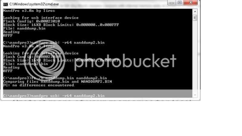

Do i have to write the nand twice like read the nand to have a matching dump?
---------- Post added at 14:35 ---------- Previous post was at 14:27 ----------
For future reference, the +w64 switch is for writing the XeLL (ECC) image to your console's NAND.
esbmaepo
Oct 2, 2011
461
Esbjerg - Denmark
No once is enough
