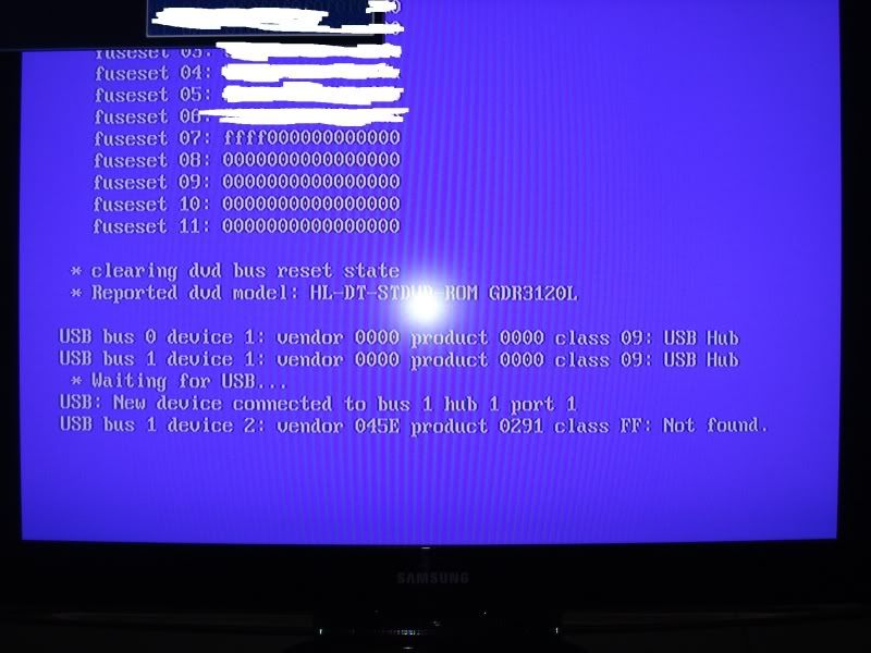

Help..solid green light jtag.
The original NAND image from which you made the freeBOOT image probably had bad block(s) in it, right? If do, try remapping the image and see if it works after that.
playingmax
how would I remapp image?
What's installed? XBR? FreeBOOT?
How was it built?
Do you have a good NAND dump?
freeboot is installed on it. I belive marshamods used jtag tool

yes it will be the problem connect the drive and redump the nand and in the jtag tool make sure it says you have a dvd connected theres a tab with the option in. MM will have put the option for no drive hence its not working with the drive.
Also do a quick queck remove dvd does it work?

Take out the drive and try boot it if it was running fine before see does it boot if it doesn't then i don't think its the nand it looks like its on its way to the GPU going but not quite there yet to give you and error code, black screen and one green light i'v had a few 360s this way did a reflow on the GPU and it sorted it just a guess seen as it was running fine when you got it.

when you start with eject it boots into xell :) Freeboots on it. Press power button or controller button to start.
You original NAND image probably had bad block(s) in it. Try remapping the bad blocks and see if the freeBOOT image then made works or not.

Just for the record, if freeboot was compiled with no DVD drive option it doesn't matter. It still should boot into freeboot whether a DVD drive is attached or not. Tested and trialed before. So this won't be the issue.

i had this problem with 2 xenons, I was told to recompile freeboot and try a fresh set of diodes and it worked Good luck
