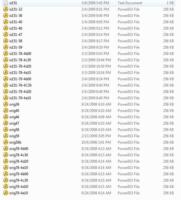

if youput all the firmware into the jf firmware folder, then jf will autoload it for you.
either that or post a pic of the hitachi tab on jf when your drive is connected and ill tell you what firmware you need.
BGAMods
Jan 20, 2010
10,082
UK
bgamods.co.uk
if you put the 4 1.51-79 files into the jf firmware folder then jf will autoload it for you.. theres 4 different drive revisions for the hitachi 79 mate so i dont know which one you have. if you folloow the jf guide youll be fine. do you have the 79 unlock cd?
Dubber0844
May 8, 2010
67
yes I have the unlock cd
