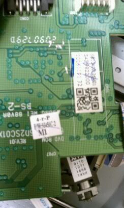

i think i broke my lite on 9 series
r0ckinricky
Oct 1, 2010
i put the trace cuts and tried to mod it and didnt work so i said screw it solder the points back turn my Xbox on and got red rings i take the drive out and it stars up put it back in red rings whats wrong any way to fix
thank you
sick360mods
Mar 22, 2010
2,918
Longisland , New York
1) u need to take some of the green of by the cuts use a fiberglass scratch pen for that
2) the solering is supposed to connect the traces not for the soloder to go in the whole cuts since ur cout went out side the trace.
3) remove solder and then resolder.
