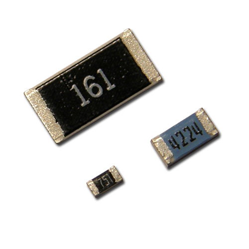

however i do have a problem with the zephyr i was given the guy who gave it to me was no gud at soldering so i decided to remove all wires and start a fresh when i relised that he had lifted a trace from the pcb (r4b24) hana chip so i bridged the trace and now i find the consoles has no power i have suplied all pics of mb to aid in my quest for help

On the left side of r4b24 where you have the trace repair started - seems like a lot of solder. Your sure its not accidentally connecting two traces?
Also, the resistor may be lifted or dead as well. Remove it and grab a 33ohm resistor ($1.19 for 5 pack at radio shack) to replace it. Just connect one end to your trace repair wire and the other to the right side spot the old surface mount resistor sits now.

The 33ohm resistor would be for replacing the r4b24 resistor if it needs it... and I would go with the wired one personally.
As for pll_bypass, I would just try to re-tin it if possible. I agree you should use a fiberglass scratch pen to reveal the trace first though.

ps can i test the resistor using a multimeter i have this one http://www.maplin.co.uk/domestic-multimeter-37279 and can you tell me by looking at it which setting i should use .

Yes, of course you can test the resistor with a multimeter. Set it to ohms and see what comes up. Remember its a 33 ohm resistor.
I didn't get a larger pic to pop up with detail of your multimeter, but Google will help you if you need to know exactly what to set it to, ok.
