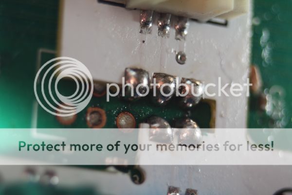

I have updated my nand-x today to v3 via the special USB cable
has Red and yellow light on.
Slim QSB and cool runner is soldered in, I'd say the points look good.
Nand will not not dump in J-runner.
can not continue
can not continue
can not continue
this is driving me crazy.
I've also put a QSB in another slim mobo to see if it would dump but nothing
help please

Have you tried dumping with NandPro v3?
Do a test dump (nandpro usb: -r1 nand.bin) and if you get a Flash Config of 00023010 and a valid NAND output, then your soldering isn't the issue.

Try reprogramming the nandx.
TrY diffirent cables and double check your soldering,use multimeter to check also.
Try using another computer and nandpro
These helped me in same suitiation.
Maybe direct soldering to board with another cables will help.

Nand-x sounds faulty, I have read quite a few threads on here with people saying there's have stopped working, but that's normally after powering on the xbox with it still connected
