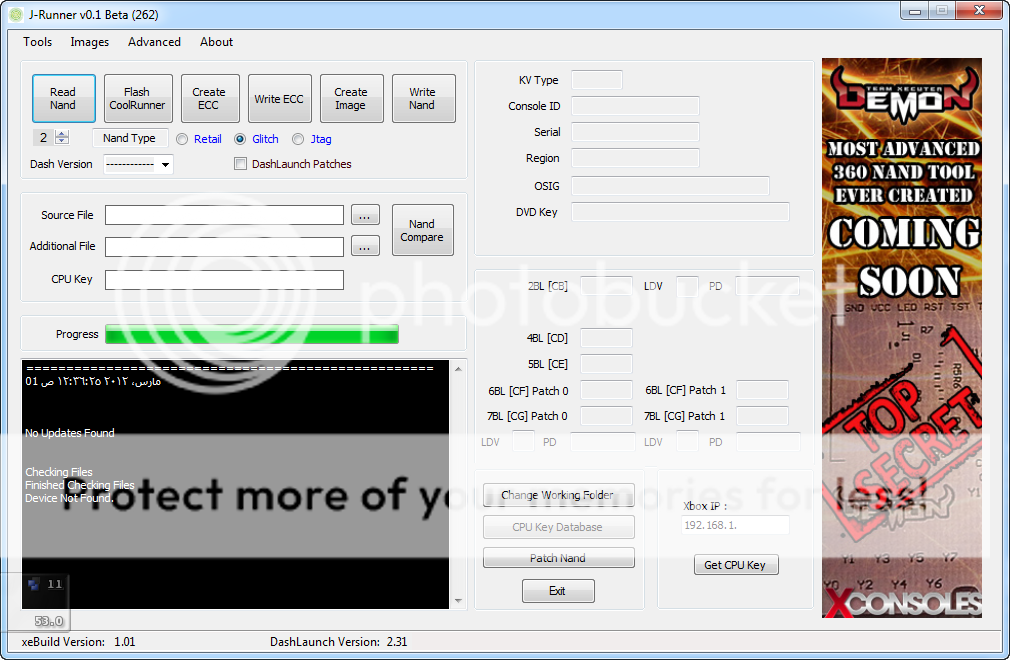

J-Runner (Device Not Found)
alzaabi
Jun 11, 2011
18
1- QSB is installed
2- Coolrunner is installed
3- All Cables are conneced to the QSB and the Coolrunner
4- Green and Red lamps are working
but J-Runner says (Device Not Found)
I have Windows 7 Enterprise updated x64

I forget the power is connected and the Xbox 360 is not turned on ...
1- QSB is installed

Are you trying to read the NAND or program the Coolrunner?
From what you have stated with the Coolrunner's green light being lit, it still needs to be programmed.
What, of the two, are you trying to do right now?
EDIT: Oh! I didn't see your additional info hiding out in the bottom of your post. Did you get it sorted already, or you just stating that it was also plugged in?

I updated my Nand-X Drivers again
and the J-runner says "Can not continue"
