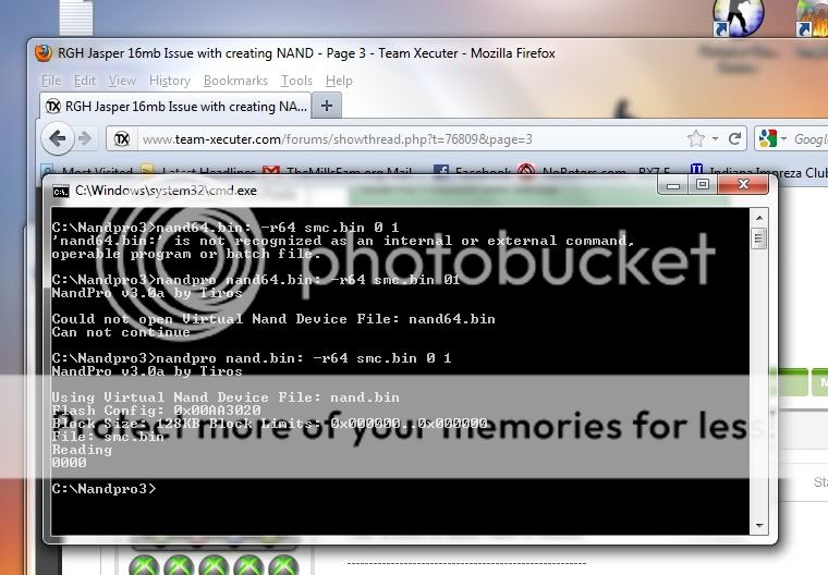

before you do that, run this on your new 64MB nand:
nandpro nand64.bin: -r64 smc.bin 0 1
Paste the output including flashconfig.

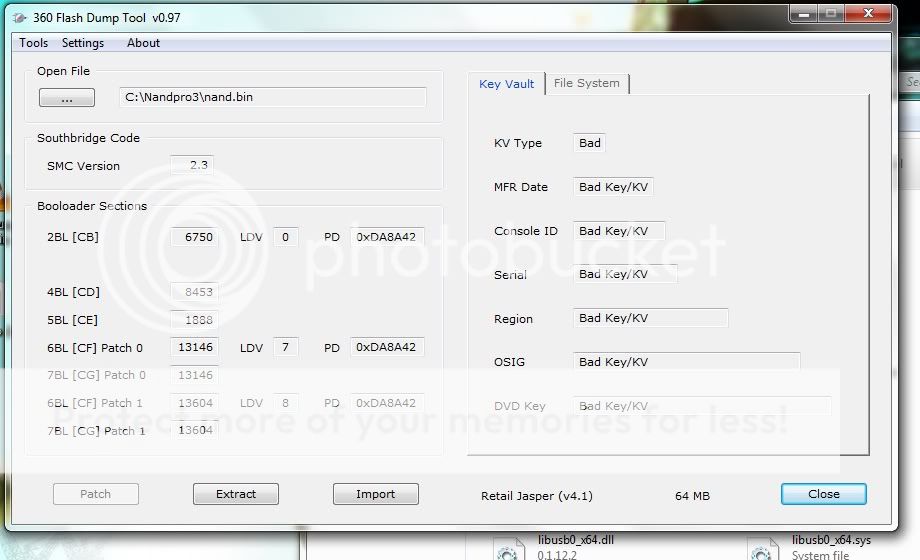

take your LDV number from XeLL (count the FFs in lines 7 and 8).
Put that number in options_r.ini in Multi_builder.
run that nand.bin through multi_builder and make a retail NAND with it.
Flash to your console with rawflash and make sure it boots.

fuseset 07: ffffffff00000000
fuseset 08: 0000000000000000
So, the ldv number is 8 right?

Whoops, guess I wasn't clear on the process of the ecc. Yes, I have the CPU key.
Yes, that's exactly what I've done with rawflash at the end. I haven't tried nandpro though, I'll try that tonight and post the log.
