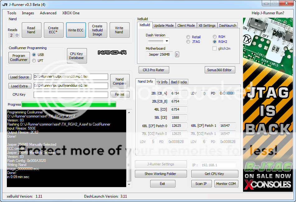

CB version: 360 Flash Dump Tool has stopped working
Screenshot of NAND details from J-Runner:
images linked
J-Runner log:

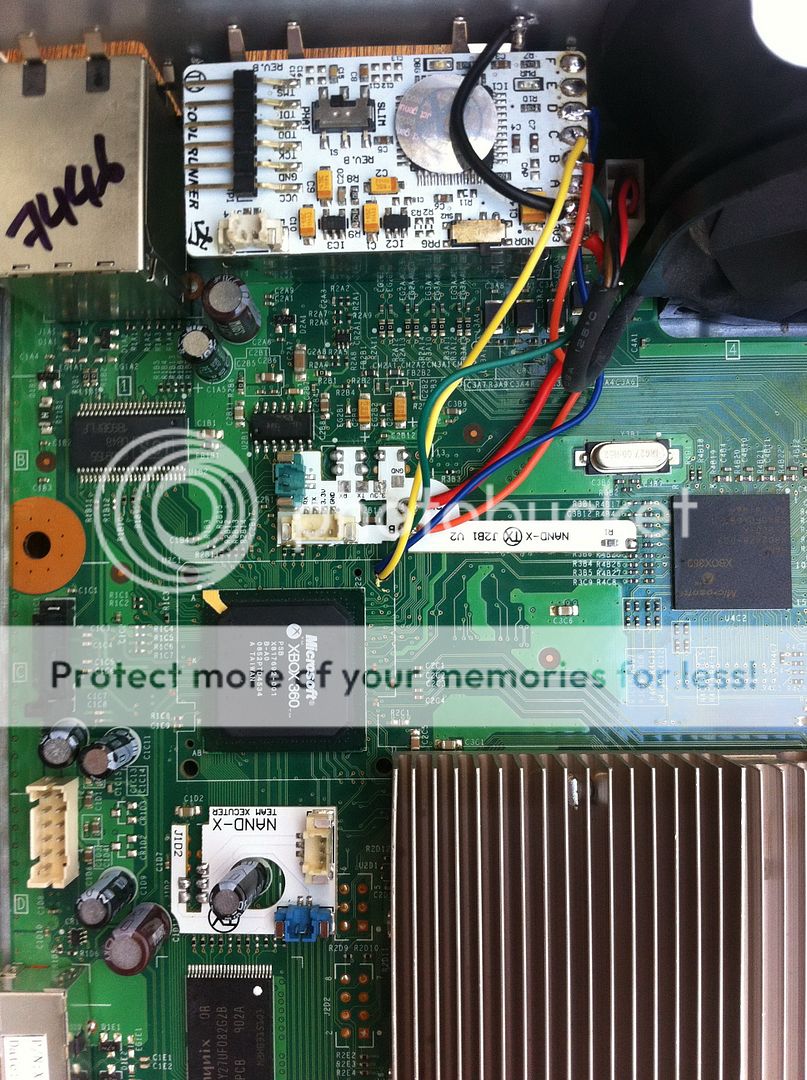

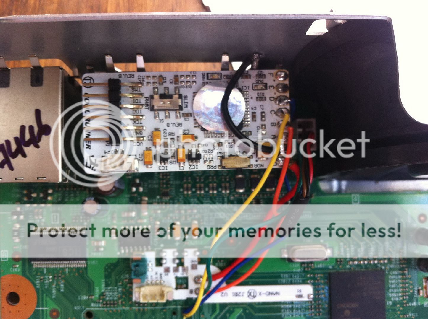

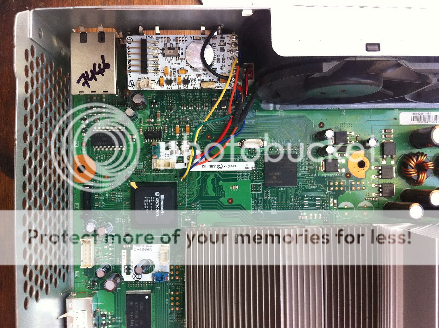

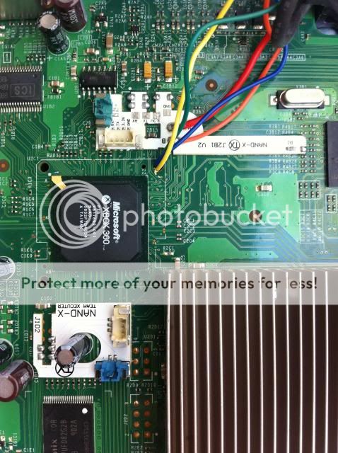

It looks like you have it wired up for RGH1, maybe the angles are just bad
I believe it's RGH2. The E & F wires go to the underside points.
It might be worth seeing a pic of those too.
Utmad
Aug 15, 2010
3,304
Southampton, UK
same thing no video ... I have not soldered E & F cables .. I did not find a diagram of that ..
any help ?
Follow the instructions for RGH 2 from Jrunner all the diamgrams are in there

only ignore them if they are outside the first 50 blocks. as this is where the ecc is written. also try different capatator/resistor combos on the cpu_rst line, some times these phat consoles are stubborn as far as glitch times. also try the falcon timing file.
