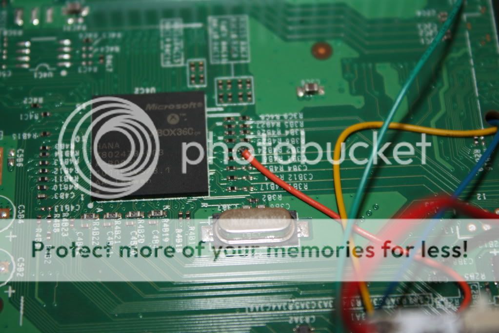

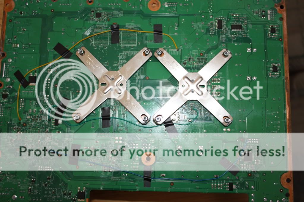

Edit: I also tried moving the blue wire to the top side of the board as well. I reflashed original nand and with cr in pro it boots fine. if cr on just red light as it should. reflash ecc and cr red on green flashing, I have tried rebooting and leaving it for around 5-10 minutes at a time. Any other suggestions would be great.

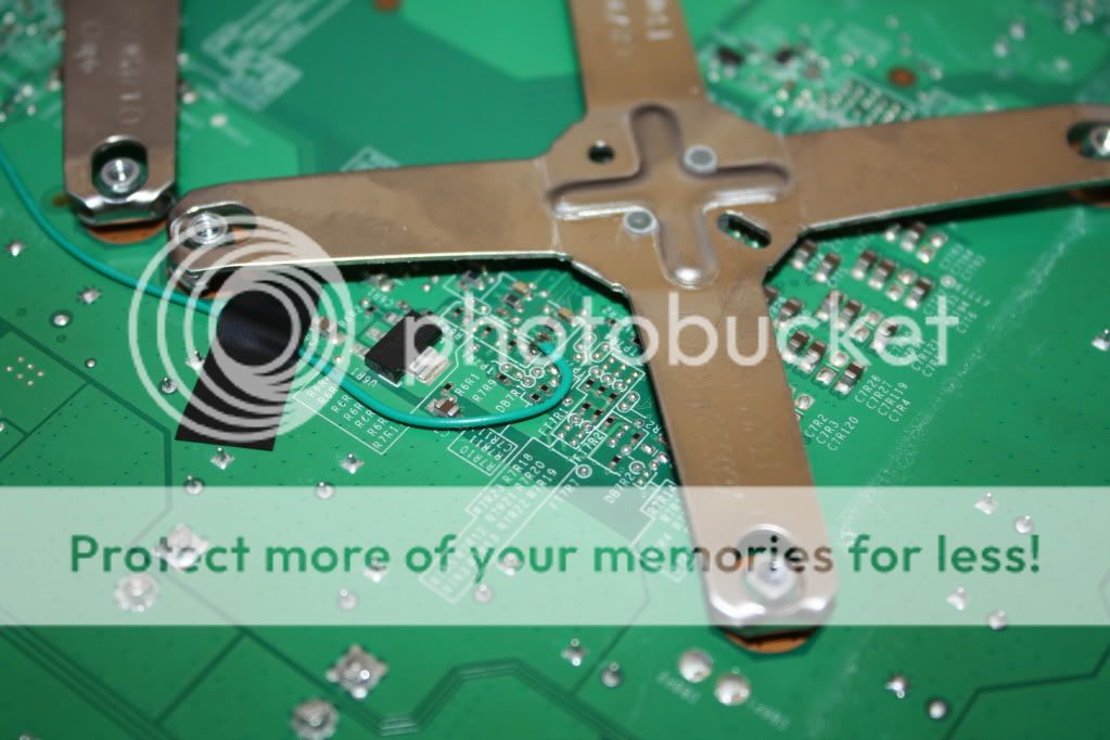

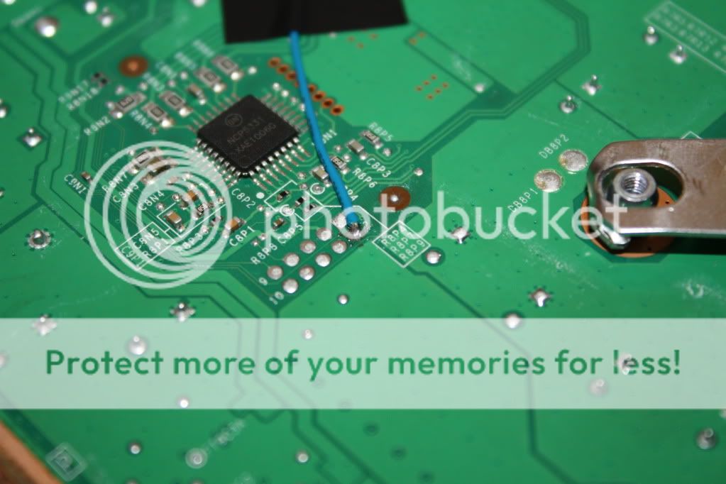

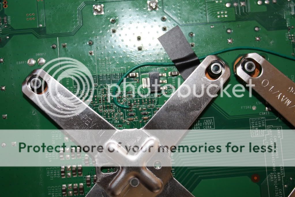

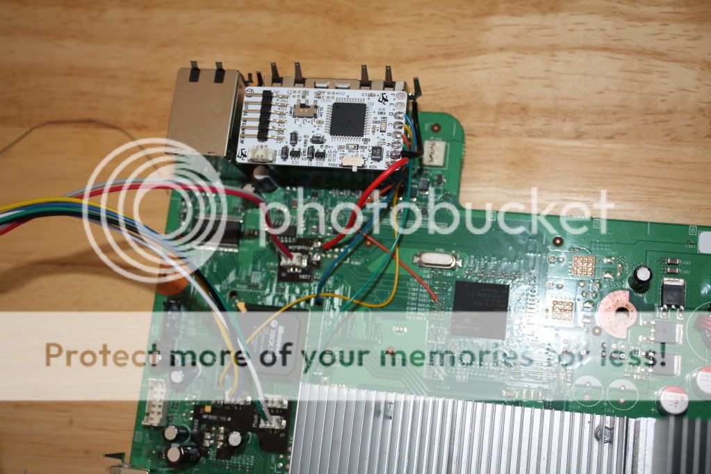

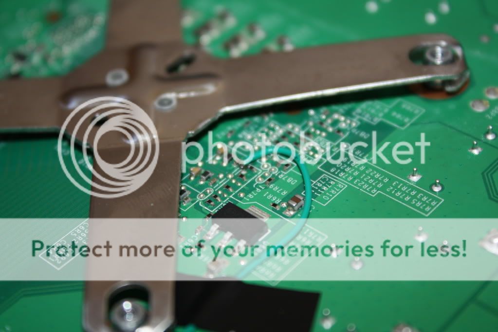

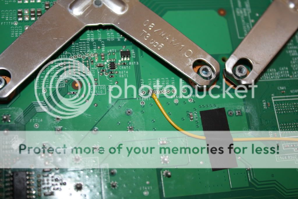

Here are the pics of my board.

I took the pictures with out the cap. I have tried with the cap, it is on it now, same results.

I already resoldered it all again after cleaning it all up. I also tried moving the blue wire to the top of the board. no fan speed pulse.
