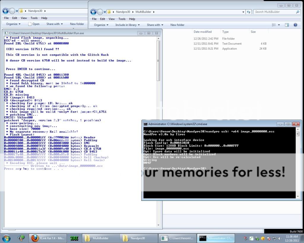

From your response to a different thread, I tried booting with the orig nand with the cr on, I get 2-3 green flashes and the it boot the orig nand. That should mean that the cr and soldering are correct? If so could it be an error with the ecc file or creation?
Possibly, yes.
What are you using to create the ecc?

I have been using multibuilder 0.7. I also tried jtag tool, but then the green flashes forever with no boot on orig nand either.
