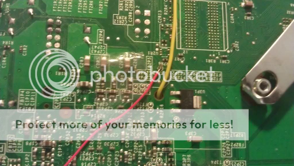

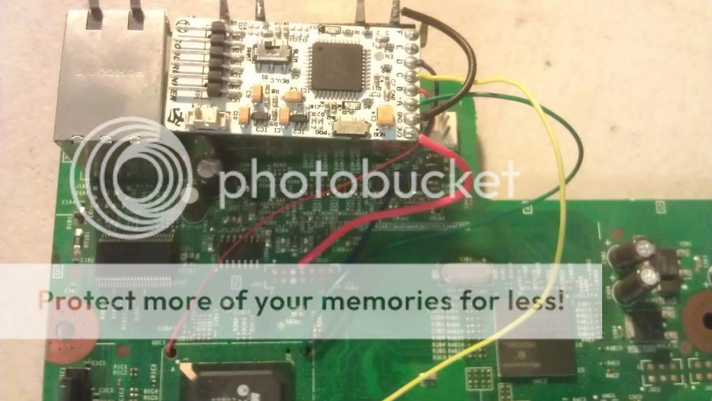

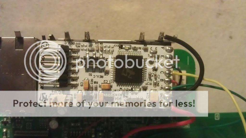

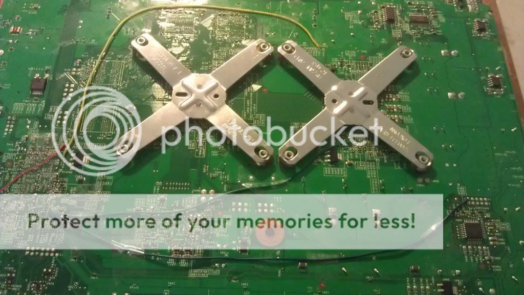

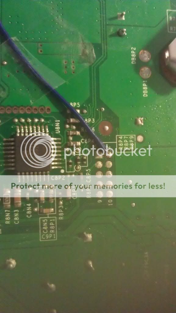

http://i419.photobucket.com/albums/pp271/jacinto8a/Jasper 6750/IMAG0087_zpse576cfa7.jpg
http://i419.photobucket.com/albums/pp271/jacinto8a/Jasper 6750/IMAG0092_zpsfcfcfba8.jpg
http://i419.photobucket.com/albums/pp271/jacinto8a/Jasper 6750/IMAG0091_zps476cdb4c.jpg
http://i419.photobucket.com/albums/pp271/jacinto8a/Jasper 6750/IMAG0089_zps445d2935.jpg
http://i419.photobucket.com/albums/pp271/jacinto8a/Jasper 6750/IMAG0088_zpsbd77ff8f.jpg
http://i419.photobucket.com/albums/pp271/jacinto8a/Jasper 6750/IMAG0085_zps011d445d.jpg
http://i419.photobucket.com/albums/pp271/jacinto8a/Jasper 6750/IMAG0083_zps51f0fe3b.jpg
http://i419.photobucket.com/albums/pp271/jacinto8a/Jasper 6750/IMAG0090_zpsd6f81f7a.jpg

Your install is clean apart from the extra-length wires-I will suggest trimming the wire to correct length and also try running the blue wire from the top around the heat sink. Your JRunner log is incomplete so the question is obvious but necessary-have you written xell to your NAND? Have you tried booting your stock NAND to confirm that it works?

Hi jacinto8a ,
u got to do some good exercise to get the jasper glitch.
1st use a 68 nf capasitor to bridge point A and ground.
2nd use 68 nf capasitor via point D..
If ur using REV c remove the Unbridged C15
Bridge the JP points
See if this helps.

It doesn't work moving the blue wire up too, neither with the shielded.

I was having similar issues with my Jasper until I stumbled across this thread.
I decided to change my wire pinout from the ones provided with the J runner
program, to the layout shown in your pictures except for the blue wire which I
left on top of the mb. I then decided to re-program the CR using the "glitch" option
instead of "Glitch2" that I had been previously driving myself crazy with trying dif time
settings. After re-programing it booted into xell immediately (2-3 seconds). Anyway, hope
it helps.
