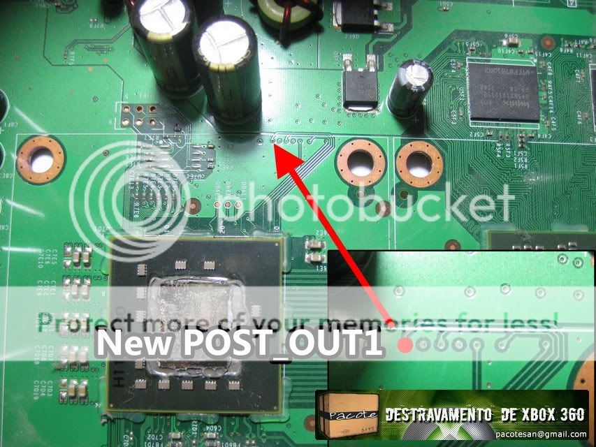

I have used an alternate point, after the pad came off when redoing all the connects after it had stopped working.

Bridging a solder point is on the new rev2 coolrunners and is for on board cap activation, Your blue wire doesn't look that great, Hard to tell from the blurry pic, I have read some cases of block size being recognized wrongly, People thinking their machine is 16k,256k,512k when it's something else as the memory wasn't showing in xbox memory setting, Maybe worth eliminating after you recheck your wiring if all else fails.
