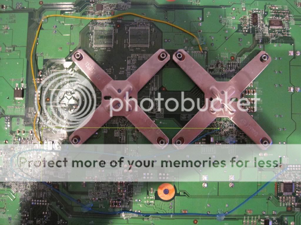

Just looking for some collective knowledge on some boot time fixes, for my new jasper 16mb
It takes around 30 secs to boot, with and without the capacitor between A and Ground.
I have aligned my wires on the bottom as by the included picture, this configuration has given me instant boot times on other consoles
So anyone got any suggestions on how to speed this old man up!!

Hey Vet1ge,
I know what you're saying with the slower boot times. I have a Jasper just like that myself.
I've been very fortunate with my boot times, on Jaspers, when I run the green wire (A) through the middle of the X-clamps. Through the left one - straight over to the right point.

I had a jasper that was really bad I found no matter how much I repositioned the wire...anyways the problems were above the mobo my blue wire was too close to 3.3 and ground soon as I moved/resolderd it to a diff position blam instant and 5 sec boots its was just this 1 jasper too as I wire everything now same as before.....jus my 10 pence :)

Now that is something I didn't think of! But the magnetic field generated from those higher voltage and current wires, could cause some interference, I will investigate this, as my wires are almost touching. Out comes the hot glue gun! I'll let you know if this creates any difference. Thanks for your input.
This is exactly how I do mine and have yet to have an issue :)

Well this morning, after a trip to the hardware store for new screw bits, to actually get back into the console. I have been experimenting and have finally got a first or second time boot.
Now jaycboy's suggestion of keeping the blue wire away from the power lines, is a very valid point, but when i opened up the console I noticed i had already positioned it away from the 3.3V and Ground wires, so I will not be testing this in this experiment.
Original Setup - With / Without 48uf Cap was 2mins + ( I just gave up after 2 mins)
Then to put the entire soldering issue out of the way, As Martin C is correct most problems are in soldering. I re-soldered all the points, with flux. And still no change, tried booting for 2 min and still no boot. (Tried booting 3 times, same result) Same result with the 48uf capacitor.
So then i went onto, repositioning the green A wire, as first suggested by XJonnyGunsX under the heat sinks. Making sure there was a good connection, to point A. Now with no capacitor, same result no boot after 2 mins. But after adding the capacitor, boot after the second flash. And third flash the second time, and back the second on the third boot.
So i can conclude that positioning of the A wire, does effect the boot time, on this console With the capacitor installed.
With this still not being instant, I though i would try repositioning the blue CPU_RST wire to the top of the board. I completely replaced the wire with a new one, and after stopping the solder escaping through the pin hole, I managed to position this wire. Still using the capacitor and the repositioned A wire, There was no change in boot times.
I cannot conclude on the effectiveness of repositioning the blue CPU_RST wire to the top of the board. As I did not try it independently of other fixes, but it appears to have had no effect, and is easier to install and keep away from the coils, So i will be using this point in the future. It can't hurt can it?

Thanks for your input, however it's important to note that positioning of CPU_PLL_BYPASS and CPU_RST wires WILL make a difference. It's just in your case you didn't see (or experience) as the cap helps filter noise from CPU_PLL_BYPASS.
Little confused by this message. It was a combination of the positioning of the wires, and the capacitor filtering the noise, that made the console work more effectively. Just you make it sound like I out-ruled the wire positioning.
