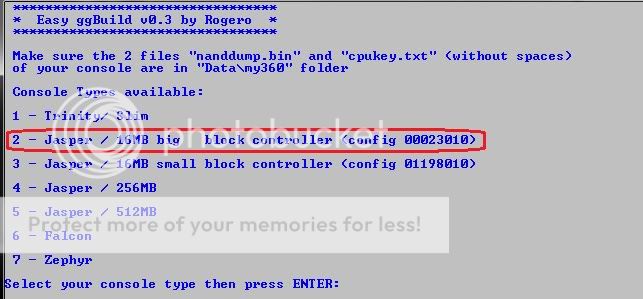

ok i have original nand dump with nanddump.bin
got cpu key on txt file named cpukey.txt
got 1blkey on 1blkey.txt file
all in mytrinity folder of ggbuild
got ldv 9 as the original dump set in options.ini file
i extract all files except filelist.ini on folder 13604
and then i run cmd on ggbuild folder, and execcute this command:
ggbuild -c jasper -d mytrinity -f 13604 updflash.bin
are these right?

hmmm as i see here
mine was the big block one of the 16mb jasper nand, maybe that was the problem?
Aiosforos
Nov 2, 2010
138
that was it, the 16 mb jasper differences
console runs perfect now, thanx for all your help
EDIT argrrrrrr still freezes.....

I had a Jasper that kept freezing, slow boot, etc. I had 2x 68nf and 1x 68nf and still had issues. After messing around for a few hours I started trying different CoolRunner images and wrote the 16mb Jasper file to a 256mb Jasper and the unit works perfectly so you may want to give that a try.
