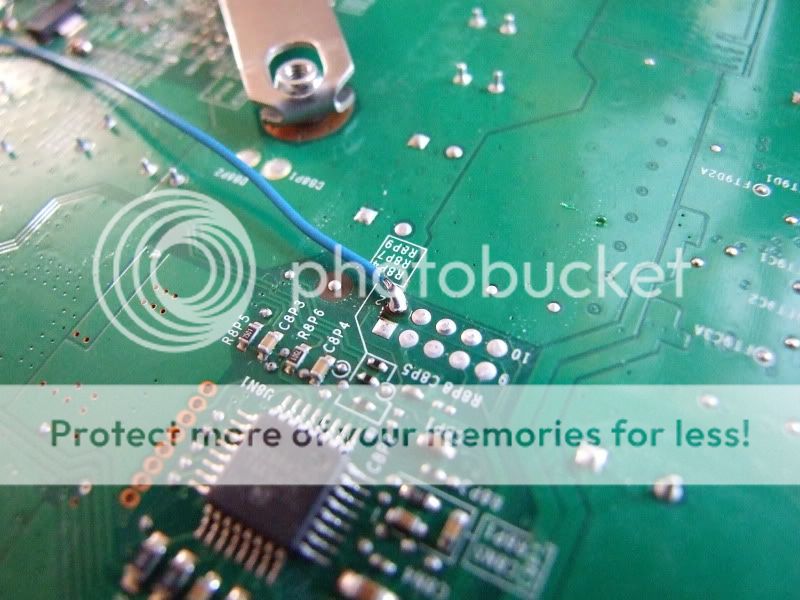

Someone has arsed this up, all I have is the ECC on the nand, Is it correct, who knows. Some of the resistors around the PLL_BYPASS were missing so Ive replaced them, Not 100% sure if Ive missed any or added 1 too many as Ive not got another Jasper to compare it against.
I didnt snap the QSB BTW, Thats how It came
All I am getting is 1 flash of the debug LED, Ive been over everything, Checked continuity in all the relevent places, Resoldered the CR wiring but nothing. Ive used a ECC from the last jasper I did but that didnt help. I struggling a little now.

The CPU_PLL_BYPASS wire doesn't need trimming, no wires need trimming for phat consoles.

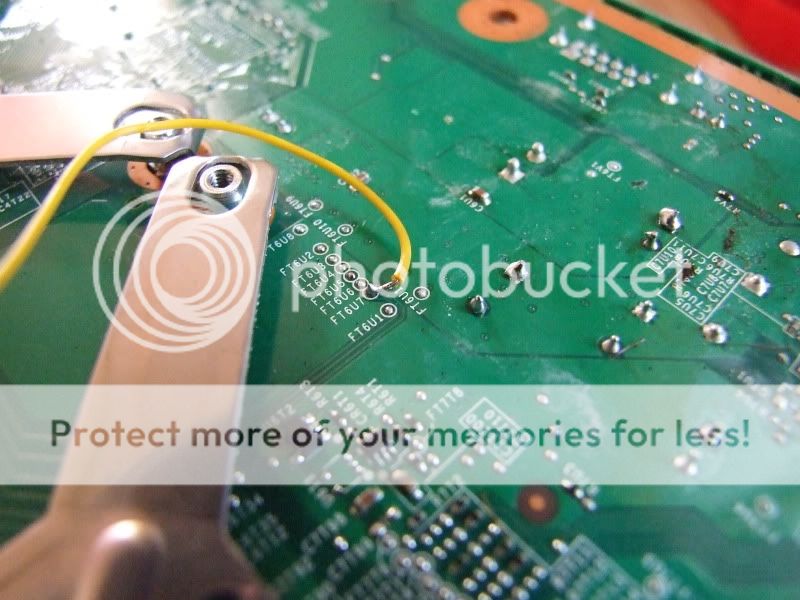

I'm not too sure about that STBY_CLK point.
What I would suggest is you solder to the alt STBY_CLK on the underside of the board (I believe it's FT2R2) and I would also unsolder the CPU_RST, take it across the top of the board (right next to the fans) and solder to the top side of that point. This helps reduce interference from the coils and the CPU_PLL_BYPASS.

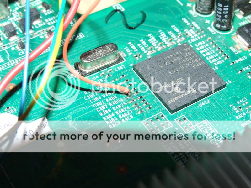

Soldering looks good but I noticed that one of the resistors near the CPU_PLL point is not on its solder pads properly. (Looking at the picture its 2 pads left of the 10K ohm resistor directly under the CPU_PLL point).
I would go over those resistors again with flux and make sure they are set nice and straight on the pads.
Don't know if thats it or not but I know I've run into issues involving the resistors before where it looked like everything was fine but after going over all of them with flux again to make sure it had a nice strong clean connection everything was fixed for me. And the main point that will cause problems with glitching I believe is the CPU_PLL, so all parts near that point need to be in working order.
