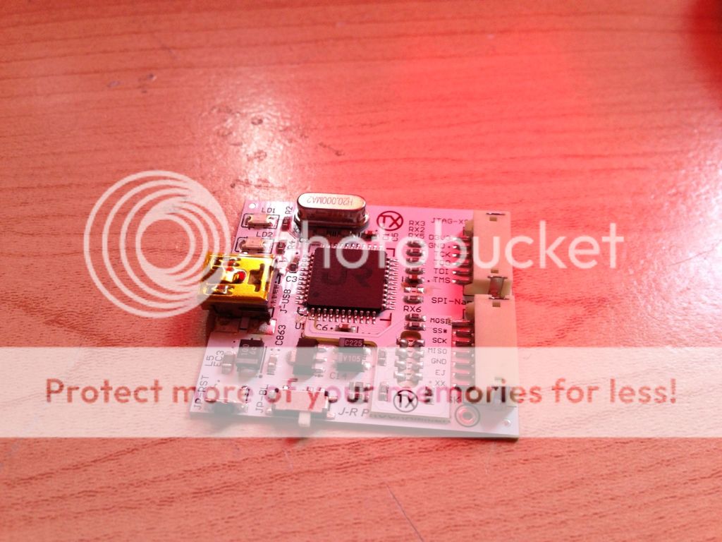

I just got mine in the mail today and i went to install it to the computer, but nothing seems tow ork. It keeps coming up as USB Input Device no matter what I do. Could anyone help?
halolordkiller3
Jun 23, 2012
Is that upgrade board making good contact with the IC pin and the MOSI pin?
What happens when you press the reset button?
I sure hope it is since I bought it that way lol, but when I press reset it restarts it but will still show red no matter what. I'm not sure why Windows won't let me install the other drivers. It sets it as USB Input and when I go to update the drivers it says they are up to date.
Also uninstalling the drivers does nothing.

Are you using a USB Hub. I had this issue using my both my USB Hubs (powered and non-powered). Switch to a USB port on the back of the motherboard and it worked right away.

No. I tried it on another computer and still it is saying its a USB Input device.

Wednesday, October 24, 2012 5:09:51 PM
J-Runner v0.2 Beta (283) Started
X-Consoles loyalty bonus - DEMON15OFF until 31st
Bootloader Attached
Bootloader Version: 1.0.4
Erasing Flash ...
Writing Flash: ..............................................................................................
Verifying Flash: ..............................................................................................
Restarting Device ...
Finished!
Bootloader Removed.
Bootloader Attached
and then I unlug it, move the switch to the right and plug it in and still says:
Bootloader Attached
with the red led.

Did you try manually installing the drivers
Also if you updated the firmware did you get any little x's. If so you will need to do again

I did get X's in the past and I know that means that was an error at that point so I re-flashed.
To your second question I tried installing them manually (both by navigating to the folder that the drivers are in (i.e the xecuter_jr_programmer_drivers folder) and right clicking on the PRUFTECHNIK file and that won't let me.

did you answer martins question on what fw you're flashing it with?
and while its verifying, move the switch away from reset button

Wrong fw then, either use ISD one (NOT the isd bit) or UPGRADE
