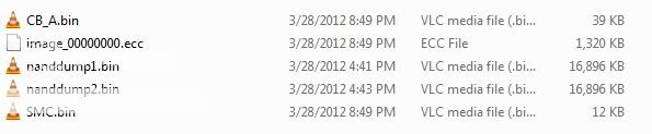

this is the folder from the jrunner
do i have to load anything else to continue to write ecc ?
how do i load that image_00000.ecc ?
thanks

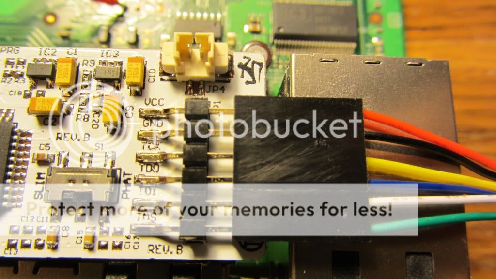

is it a problem that the nand-x to coolrunner doesn't enter completely ?
i just checked the points and seem fine so dunno, what to do, i will take pictures of the points and post again

If you've programmed the coolrunner, you should be unplugging that cable. It's not needed again unless you wanted to reprogram it.
then i'm doing everything wrong, i was trying to write ecc pluging that cable to the coolrunner from the nand x while the nand x is plugged to the laptop.
then how do i write the ecc ?
how should be the nand-x plugged to the xbox or what should i do ?
ps. and i was here soldering again the points , i almost burn one :D
That connector is ONLY needed to program the coolrunner. You should also have connections to the Console to the NAND-x via the header points at J1D2 and J2B1 (aka NAND points).

The .ecc is to be written to the xbox and the .xsvf is to be written to the CR. If you are trying to write the .ecc to the CR then you need to stop and seriously re-read the tutorial.
