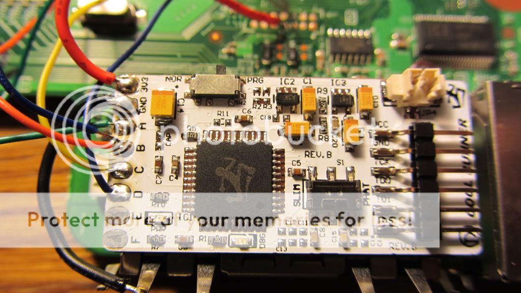

ok - bridge the point on the Coolrunner labelled 'cap'. It enabled the 68nF cap on board. You probably need it as it's a Jasper.
bridged it but still it doesn't boot in to xell nor in to anything. the green light in the middle blips.
the lights on the coolrunner are off
I assume at this point you've written the .ecc to the console and if thats the case you can flip the switch on the CR to nor.
yes i already wrote the .ecc and i haven't flipped the switch.
ps. just flipped it and a red light turned on in the coolrunner. is that bad ?

No that's not bad just means it has power. Now try booting the console and see if the green light blinks.

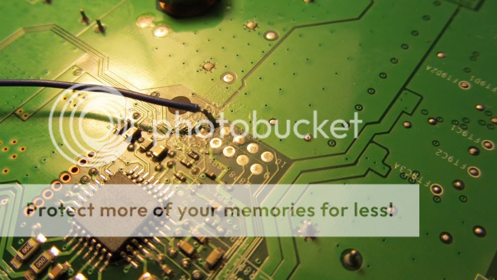

You might have to fix that STBY_CLK better, meaning soldering directly from the trailing trace to the resistor, then using the alt. point for the Coolrunner.
but before i wrote the .ecc to the nand was still booting.
i will try to fix it with the scrapping but i never got an answer if i should scrap over the copper line or only next to it ?
thanks again for all the answers and sorry that i messed up :frown:
