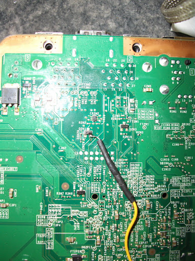

I had the same issue m8, What jtag points did u use? I tryed the top ones first with no luck kept getting E79 error when trying to get xell or freeboot to work,
use the SMC points here is a link to where the altrenate jtag points are on the board.
Try here see if you get any luck, Please remeber when making FB image if u use Jtag Tool to select SMC points in the option before making ur freeboot image.
Follow this guide for altrenate Jtag Points
http://www.team-xecuter.com/forums/showthread.php?t=55189
