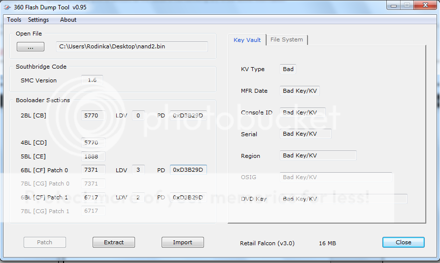

hello I want ask u i bought NAND X and install it read it and when i check bad blocks its looks like 0 bad blocks... so i write the Xell after itz i disconnect the nand x and tun on the XBOX 360 after it show ERROR 79 SYSTEM ERROR. .... if I tryed the 360 flash dump tool its show me 5770 OK but dont see me other I think importatn info like serial dvd key and other .... (i dont have connected dvd rom becasue dvd is bricked... )
and question... is my xbox 360 totally bricked ... ? or exist any ways ? :eek:

oks :D it works uff i rad the post then must set any resist aynd it works thanks uff :D im so happy :D

Good for you :). Its always a good idea to read the tutorials a second time, when stuff dosn't work!
Remember to store your original nand dump (The ones, that you read), so that you can always restore your xbox to its normal state if something happens.
