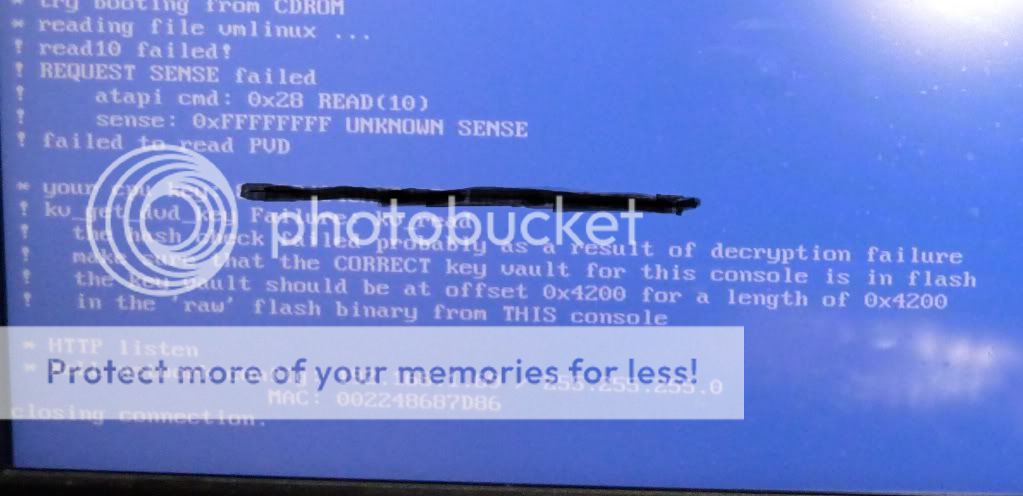

just got xell to boot but get this....

Xell will fail with the kv because you don't have it in the xell build - don't worry about this.
Is that Xell or Xellous? If Xell, reflash with Xellous.
