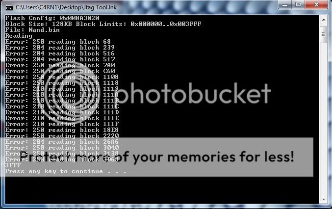

I've been trying to troubleshoot this issue i'm having. Here's a a screen shot of my nand dump.
http://i145.photobucket.com/albums/r217/Carnifreekshow/nanderrors.jpg
I've desoldered the quick solder boards and removed the solder in the holes then filled them with lead solder and made little points to quick solder to. The result is the same no matter what i do.
The xbox is a Jasper 256mb 2.0.7371 mfr date of 2008-11-08, ive destroyed one nand-x quick solder kit so far (the pads lift off the board). I'm using my soldering iron on my reflow machine set to 270C to do the soldering. I own a computer store and would consider myself to be an expert in soldering. I solder usb ports, dc jacks and audio jacks all the time. I know it's not my soldering, and i know it's not the xbox.
If someone can help me figure out what the error codes mean and help me eliminate some variables that would help. I posted in the "jtag tool" thread but haven't had any help at all.
If you need any other information let me know.
