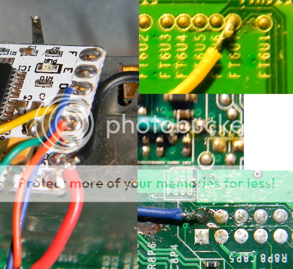

I am taking my JTAG jasper 512 and putting on a RGH XD card mod. XD card works great. I got cheap microSD to XD card and put a 512 mircoSD in it and I have no problems booting into as a normal JTAG nand. This is my first time trying to RGH a FAT i've done well over 20some slims with no problems.
So dose the jtag wiring effect the RGH? I am guessing it will not since a normal retail image will boot even with the wiring. When I go to use the RGH image on my XD or on the on board nand then turn it on. I kinda get a green light and that's its. This pic show the wiring and no the ground and power isn't touch like it looks in the pic. I've fix the blue wire that has that one strand of wire not soldered on... I didn't see that until I took the pic. It still dose the same thing though...:frown:

I went and looked at my nand file in flash tool and found out that my LDV was set at 0 which all my image dumps show. Looked around and found out you can get ur LDV number by counting the Fs in line 7 and 8 of the fuses line when booting xell. Change my value to two and it boots faster then any slim i've done! lol reflashing all the XD cards I have now. Thanx again for the help... A noob move I made sorry for the waste of thread space.
