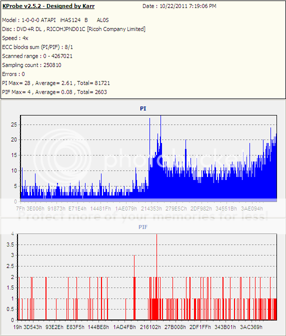

Liteon 124-19B, Verbs MKM 003 2.4x . Fails at verify 49% in imgburn 4x with same media. 2.4x Working good.
Date : 10/22/2011 10:07:09 AM
Model : 0-0-0-0 E:ATAPI iHAS124 B AL0S
Disc : DVD+R DL , MKM003 [Mitsubishi Chemical Corporation]
Speed : Max
ECC blocks sum (PI/PIF) : 8/1
Scanned range : 0 - 4267008
Sampling count : 248767
Errors : 0
PI Max : 72
PI Average : 6.33
PI Total : 197599
PIF Max : 3
PIF Average : 0.09
PIF Total : 2846

Here is Driver San Francisco written at 4x On intenso branded Richojpnd01c media code. This disk did not verify and hung at 49%, if you look at the kprobe scan it is very clear that the newer part of the disk that we are writing to is the problem and even the legendary liteon with it's amazing error correction can't read it. I really need to be able to patch these disks to write at 2.4x because i think (hope) they might be ok.

try buning @2.4. and 4 pif is the target. but its not the end of the world if it goes to about 8.:) disc are not failing verification because of the pif.
