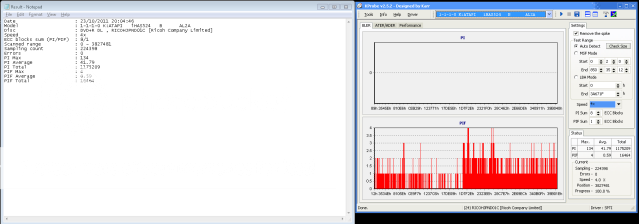

Ok here is my test using aone+ gold discs burned @ 2.4x img burn verified 100% and here is the kprobe log
Link To Image
sorry cant realy see img, so here is a copy of the log
Date : 23/10/2011 20:04:46
Model : 1-1-1-0 K:ATAPI iHAS524 B AL2A
Disc : DVD+R DL , RICOHJPND01C [Ricoh Company Limited]
Speed : 4x
ECC blocks sum (PI/PIF) : 8/1
Scanned range : 0 - 3827481
Sampling count : 224398
Errors : 0
PI Max : 134
PI Average : 41.79
PI Total : 1175209
PIF Max : 4
PIF Average : 0.59
PIF Total : 16464
Speed : 4x
Errors : 0
PI Max : 134
PI Average : 41.79
PI Total : 1175209
PIF Max : 4
PIF Average : 0.59
PIF Total : 16464
This is really shocking to me as that media code is quite cheap and nasty, yet these numbers are really good. I'd like to see the graph image.
