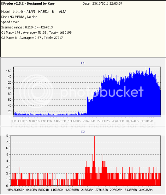

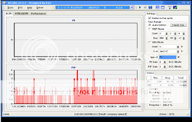

linnx88
Apr 8, 2003
90
Hmm just ran Nero DiscSpeed 5 and got great results for my Forza 2 disc 1 burn, better than in KProbe for some reason.
KProbe gave me like 1 9 PIF spike, DiscSpeed shows max as 4.
Take a look, i'm posting KProbe for the same disc for comparison, all done at fixed 4x speed.

Apr 8, 2003
90
Those nero results are both below what is considered a good burn. it has been stated the disk quality score must be 93% or higher to be considered a good burn.
Doesn't matter what nero score is considered. It's simply the combination of PI/PIF errors.
My PI is perfect, my PIF is well within range, 2 mods and people on #c4e said I had good burns. Look at uber geek's 2nd burn, and he calls that perfect, he has 1 9 PIF spike, one 7 spike and one 6 PIF spikes.
The nero results are consistent with KProbe +/- 1
All my games passed imgburn verify, kprobe, nero and installed on xbox. Playing now, no problems whatsoever with Dark Souls nor Forza 4.
