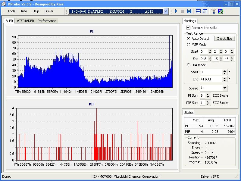

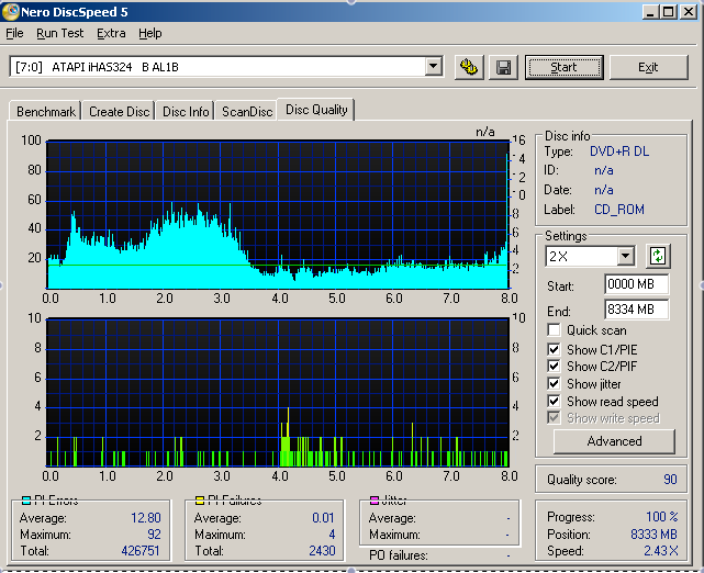

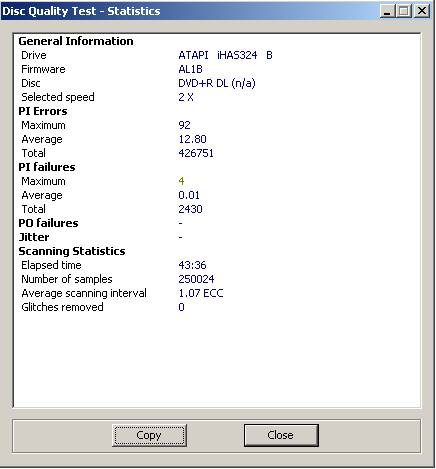

Here's my Nero Speed scan of Dark Souls.
I'm noticing almost all games I burn have a single spike in PIF around the layer break. I was told it's as should be.

That's a good point. I have good burns, but I don't like seeing even single 8 or 9 PIF spikes when I can get < 4.
I'll try running the drive off of my VIA6421. Will post back results.

Nero gives quality score of 90 = FAIL
Kprobe results = PASS

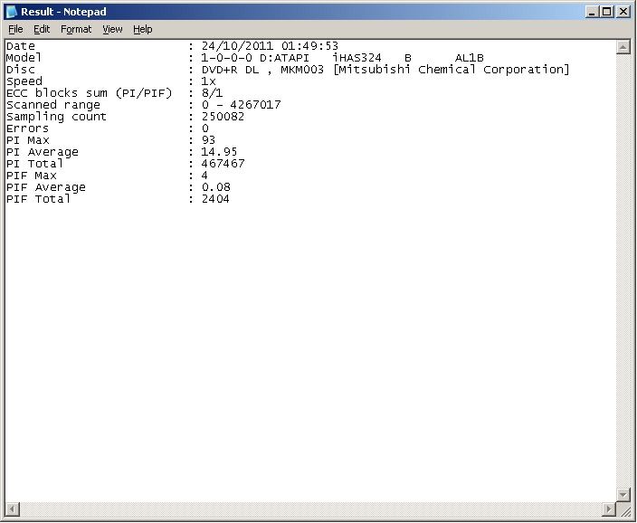

Date : 10/23/2011 6:47:59 PM
Model : 1-0-4-0 F:ATAPI iHAS324 B AL1B
Disc : DVD+R DL , MKM003 [Mitsubishi Chemical Corporation]
Speed : 4x
ECC blocks sum (PI/PIF) : 8/1
Scanned range : 0 - 4267014
Sampling count : 250308
Errors : 0
PI Max : 26
PI Average : 1.33
PI Total : 41610
PIF Max : 5
PIF Average : 0.19
PIF Total : 5844
Batman Arkham city lite on ihas324b

Here's a reburn of Dark Souls on a different SATA chip, Smart Burn On, Hyper Tuning Force On, Hyper Tuning Online On.
linnx88
Apr 8, 2003
90
Wow, what a difference turning all options like SmartBurn, HyperTuning Forced and Hyper Tuning Online off made!!!
:rolleyes2::rolleyes2::rolleyes2:
Check these out.
Both are burns of Dark Souls.
The worst result is from having the above options ON, while the best result came from having all options OFF.
