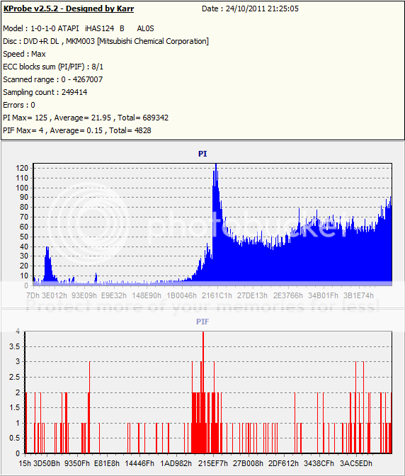

lambs_neck
Aug 31, 2011
32
Lincolnshire UK
thought i would have a got with my RAGE. The PI Maxed out at 124 with the PIF @ 4, I have read that the PI should be 100 or below will 125 be ok to use ?
Burn proof disabled
100meg buffer
opc off
Burn Speed = 2.4x
iHAS 124 B
Verb printable
100% verified

Link To Image
I think we should start banning guys who dont read - im getting tired of this. why are you asking when we clearly tell you how to read the charts ?
