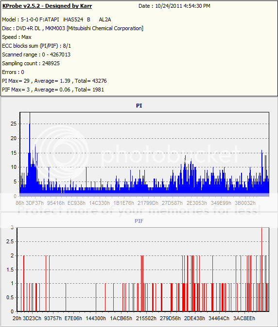

It won't get much better than this :)
MKM003, burned at 4x with OPC enabled. All the rest is default settings in IMGBURN.
External power, USB-to-SATA converter used to connect Liteon iHAS624 B to my laptop

No it won't! :cool:
Please post EEPROM settings.
One thing I definitely noticed, as somebody above have already mentioned, the MKM003s seem to produce MUCH better burns than MKM001s!
Will be getting them after I run out of 001s. Got 15 more left though :(
Didn't touch any EEPROM setting, standard flash.
And yes it's true, MKM003's produce better burns than MKM001's. I tried the same game on MKM001 and it had much higher PI rates compared to MKM003. Especially on L1.
