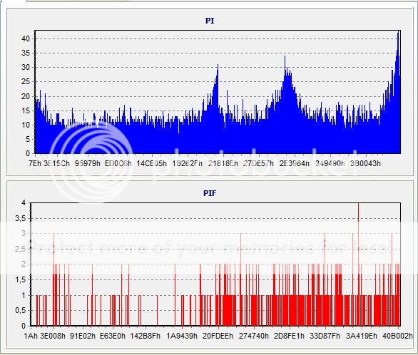

I got my batman this morning, ripped it then burnt it on my shiny new 624,
burnt on 003's from amazon, at 4x, opc on, all extra settings off, smart burn, hyper tuning etc,
here are my kprobe results,
the first is scanned on my 624,
the second was scanned on my old reliable, lol, sammy writemaster. (notice the error it threw up) I'm thinking maybe it's because it cant read the bigger layer break.
I might try to burn it again with smart burn enabled.
oh yeah chipset is nvidia nForce, amd phenom II processor, on win 7 x64,
I might even try it on my via card and see what results i get from that,
